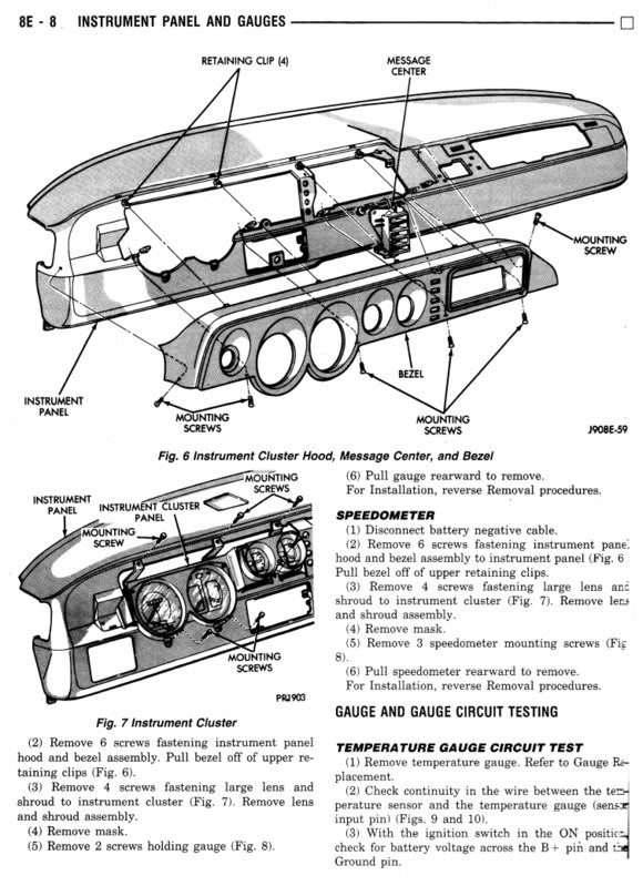

I can help you with the odometer part, anyway...
http://www.carradio.com/speedometer_gears.html
It's the second gear down on the page. Pretty easy to replace; I had to do it on my '90 B250.
The little green gear in the pic is the one you'll be replacing, though mine was black.
This is how my '90 comes apart; I don't know how different the '83 will be.
