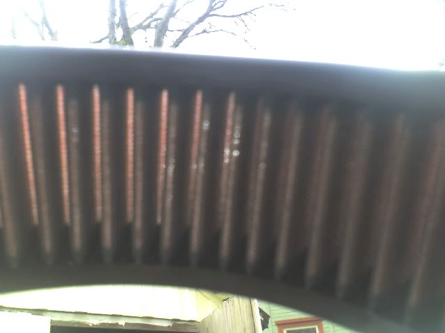

Removed the K&N air filter. Will not be reusing it.
Found holes in it that would allow dust to get through, I don't like that at all! This is not the first one I have tired. Back in 04 I had one in my Impala and after 20K found the same exact thing. I will not be trying another one.
Well that really sucks considering the cost of those things.
