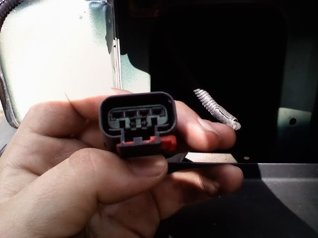

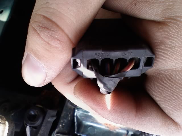

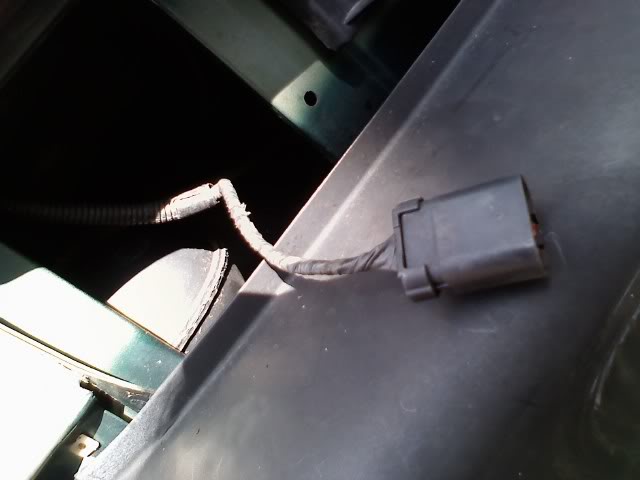

Found this connection below the passenger side headlight, behind the panel i had to remove to get to the vacuum reservoir.
if you cant see the colors on that connection
it goes from left to right:
BLACK, BLUE WITH RED STRIPE, GREEN WITH RED STRIPE, TAN WITH RED STRIPE.
It also says 52772 B-14 on that side of the connector
and on the bottom it says 4 8 2 1

thanks alloro! found the hose that was disconnected from the vacuum reservoir and i attached it and the vents started working! thankyou!
but when i took off the little panel that i had to remove under the headlight to get to the reservoir, i found this set of wires and something that has been disconnected.
pictures of the connection and the description of wires are in my main post.
thanks again
