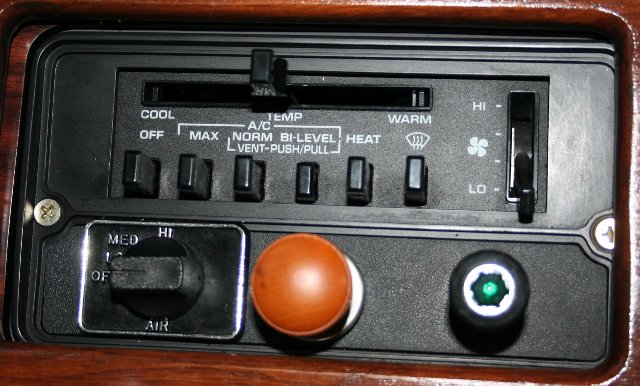

Originally Posted by Mobile Auto Repair
when you push the "vent" button then pull the button back out, that will turn off the AC compressor.
I too have wondered if it was possible to turn the AC off, and never knew you could do this!
I assume you are referring to the heater controls that look like this:
Ben
Old Feb 7, 2010 | 04:59 PM
Mobile Auto Repair's Avatar
Mobile Auto Repair
Posts: 1,174
From: North TX
Yes the Norm and Bi-level both will pull back once pushed in and turn off the AC compressor. Notice it says "vent push/pull" below the Norm Bi-level.
Also both the Norm and Bi-level buttons will have a tab at the top of them to help you pull them back once pushed, the other buttons do not have them.
