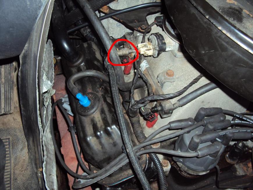

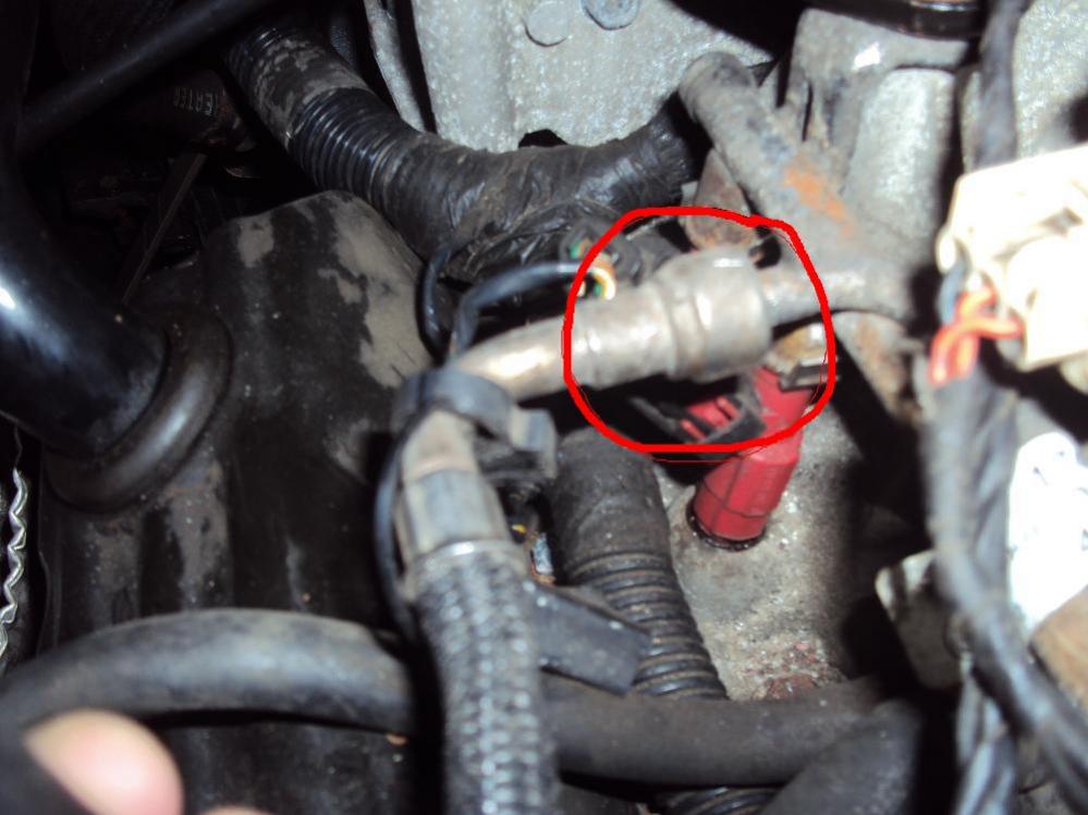

Hi, my dad 2003 dodge ram van 1500, was leaking fuel at the send line, so we disconnect the bottom line under the van, but when we got into the engine bay and try to remove the fuel line sender connect to the fuel rail, we were having a hard time removing it. hear are some picture. (the one circle in read is what i'm trying to remove)

Are you using a fuel line disconnect tool or are you just trying to pull it apart?

I'm just trying to pull it out. I didn't know there was a tool for it, and do you know if anywhere they sell this part? because i went to autozone and they don't really have what i'm looking for.

The tools are available at any auto store, including Autozone. There are a couple of different kinds, but any of them should do the job.
