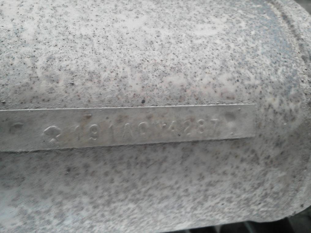

hello all!! iam in a sticky situation. ok i have a 2001 dodge b3500 van, 5.9l california emissions. my front right cat has gone out. i cannot find a replacement cat converter assy for it, nor can i get that one cat replaced. the muffler shop in town says there isnt enought room for a universal cat to be put in and the o2 needs to bolt up before the cat.
i called dodge with the vin and they tell me it should only have one cat and three o2 sensors. i have three cats and four o2s. i found a chrysler badge on the rear cat with numbers 191a0w4287 stamped on it. dodge says its not there numbers. the dealer told me good luck, litrally!! wtf!!?? so can any one help me out as to where to find the converter assy please?? and yes i googled it aswell and all i find are non california converters. thanks!!!

That p/n is not Mopar. Your van could be a victim of the last decade when illegal parts made in Asia were shipped over here looking like OEM parts.

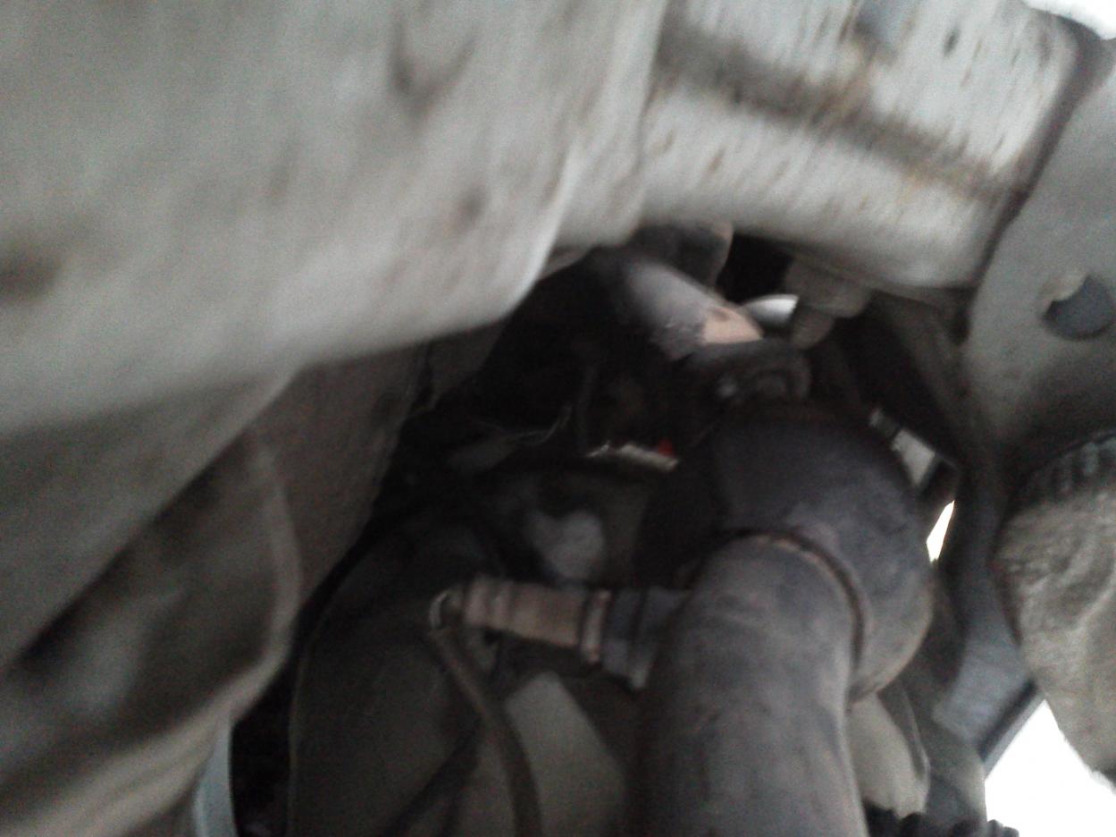

ive never heard of the asia thing. but this van has a pre cat on both banks just after the manifold with front and rear o2s then the y-pipe into one bigger cat. this puzzles me. how is it suppose to pass emissions if i cant get replacement part and no muffler shop will moddify something to work?? we have had this van sence new from the dealer.

these are deffinant cats on each bank. the o2s are monitering them front and back. the rear cat doesnt have o2s anywhere near it. im going to try to upload a pic of the system just to better explain what im looking at. and hopefully this will help anyone else who has this set up. its still dak here so give me accouple hours.

here are those pics. i included the rear cat with the (what looks like a chrysler 5star emblem) stamped part number on it. but you can see, 3 cats four o2s.

Strange logo stamping and a rather bogus looking Chrysler p/n.
The downstream CAT looks normal.
The setup for your van looks more like one for a Ram Truck instead.
Wonder how the Ram Van PCM knows how to monitor for two CATs.
