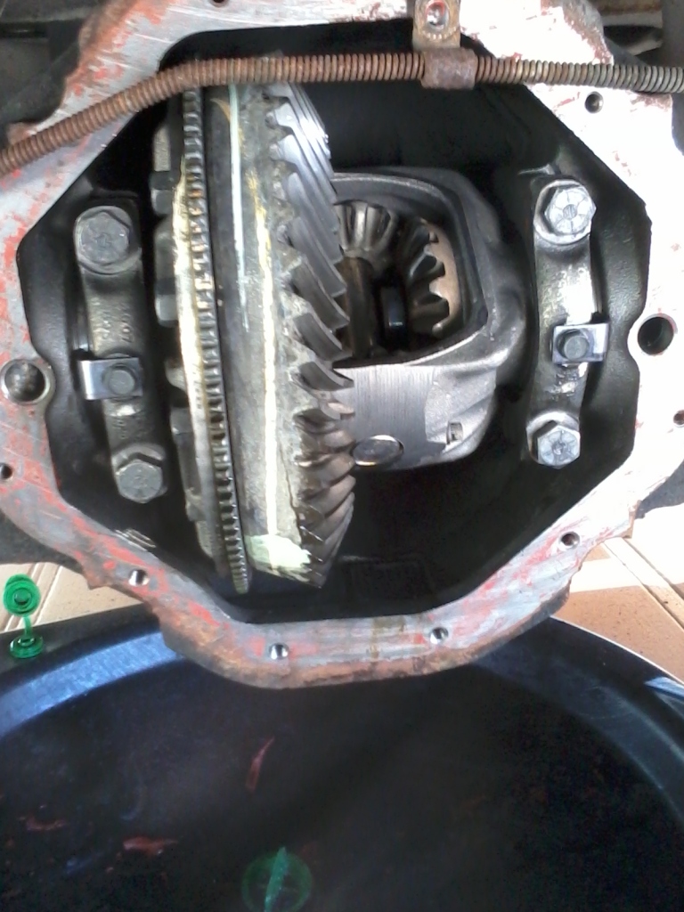

Noticed the axle leaking from the OEM rubber cover plug. Pulled out the plug to find the diff overfilled with nasty old fluid. I obtained 5 quarts of Amsoil SVG and proceeded to change out the fluid. First step, open the diff:
I cannot recommend enough that you open the diff cover, even to the people who don't have to, because you really get a good picture of the condition of things. Here, you can see that the parts are covered in a layer of nasty crud.

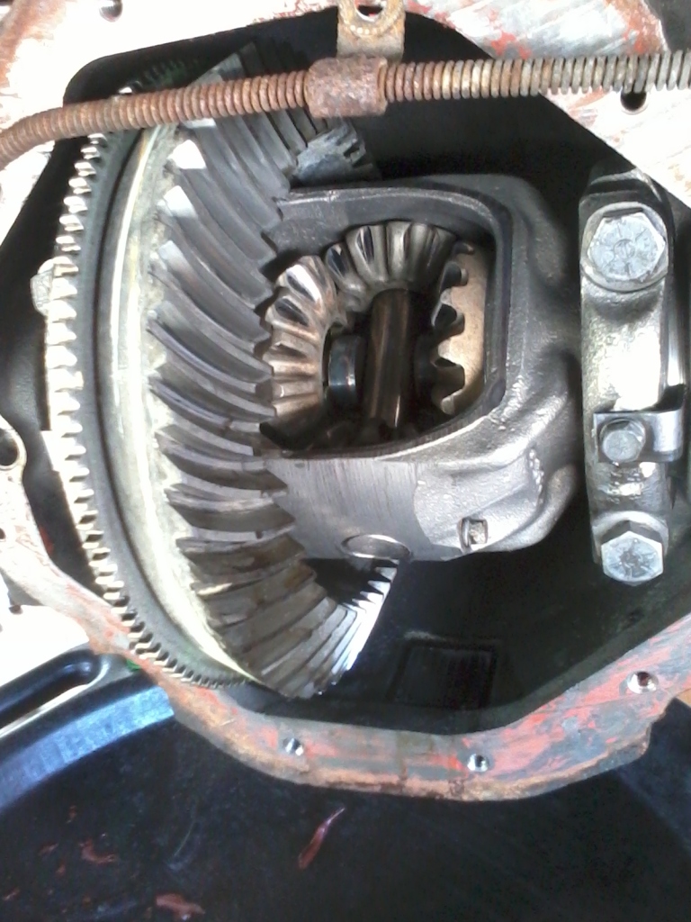

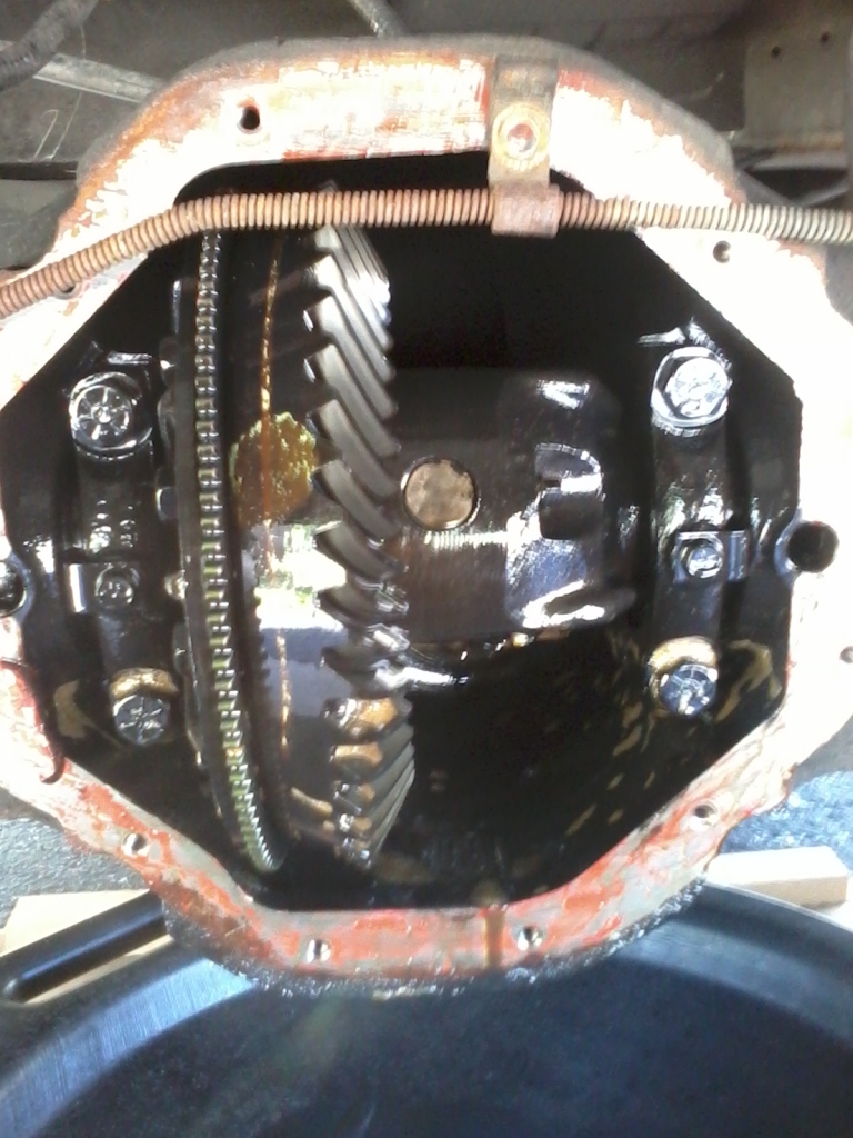

After a good cleaning with brake cleaner, the diff and case are free of the crud, and all old gear oil. You can see that wear on the ring gear appears to be correct, as it does on the spider gears. Not much on the magnet. Just a little metallic mush.
After cleaning and re-sealing the cover, filled the diff up to the proper level with the SVG, and drove. Much less humming coming from the axle, and no leaks at all. Will need more driving to know whether or not there are any mileage increases.
I was glad not to find any bad news back there. This van has a lot of miles on it, but it looks like the rear is ready to go for alot more.
