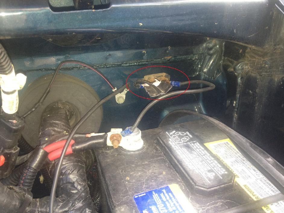

This is what I was referring to in my first post. Any idea what it is? There is a wire that runs all the way down the frame to the towing package and a couple of screw holes on the knee panel on the drivers side too so maybe its from a brake controller? The wire is cut and has split loom around it.

It's a bit hard to tell from that picture you posted, but to me it looks like someone ran a 12 volt feed from the battery back to a pop-up trailer to run some night lighting.
