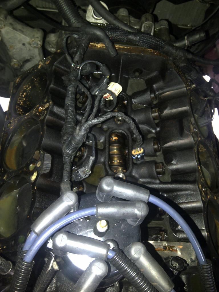

I am thinking there is something clogged back there. I have one pic below and this was when I pulled the heads to get the new lifters in. You can see the lifters and they amount of varnish on them. Do you all think this is a lot? Inconclusive?
