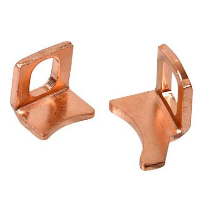

Solved the problem, it was the brass contacts inside the Starter Solenoid.
Changed the worn-out contacts and all things are back in spec.

Where did you find those ?
Old Dec 30, 2013 | 05:54 AM
BVan's Avatar
BVan
Joined: Dec 2013
Posts: 9
They're selling on eBay/auto parts store but the repair shop had them in our case.
