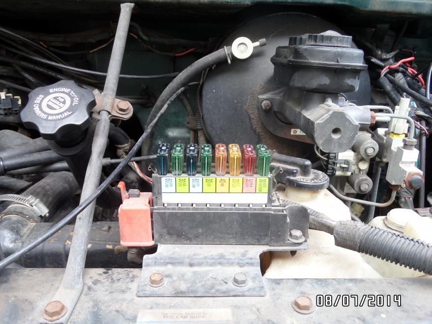

(5) Under the hood above the radiator there is another fuse block, but none of these light up the tester. Maybe I'm checking them wrong?

The dash dimmer switch. I'll have to get a scan for any code. The only fuse box that looks similar, is the one in the passenger compartment, behind driver's seat, but they aren't blown either. I'll take some pics and post them. Thank you for your response.
