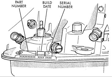

3.9L gets the 32RH (Page 51).
OP, in addition to matching pan shape/pattern, you can verify the part ID stamped on the trans.
http://dodgeram.org/tech/transmission/4xre.htm
Mopar remanufactured should also have a stamped plate glued/riveted on it.
I suppose its possible you may have ended up with a shallower aftermarket pan.
Conversions sometimes were titled with a model year +1 the actual base vehicle model year. Looking up the VIN is the right approach.
