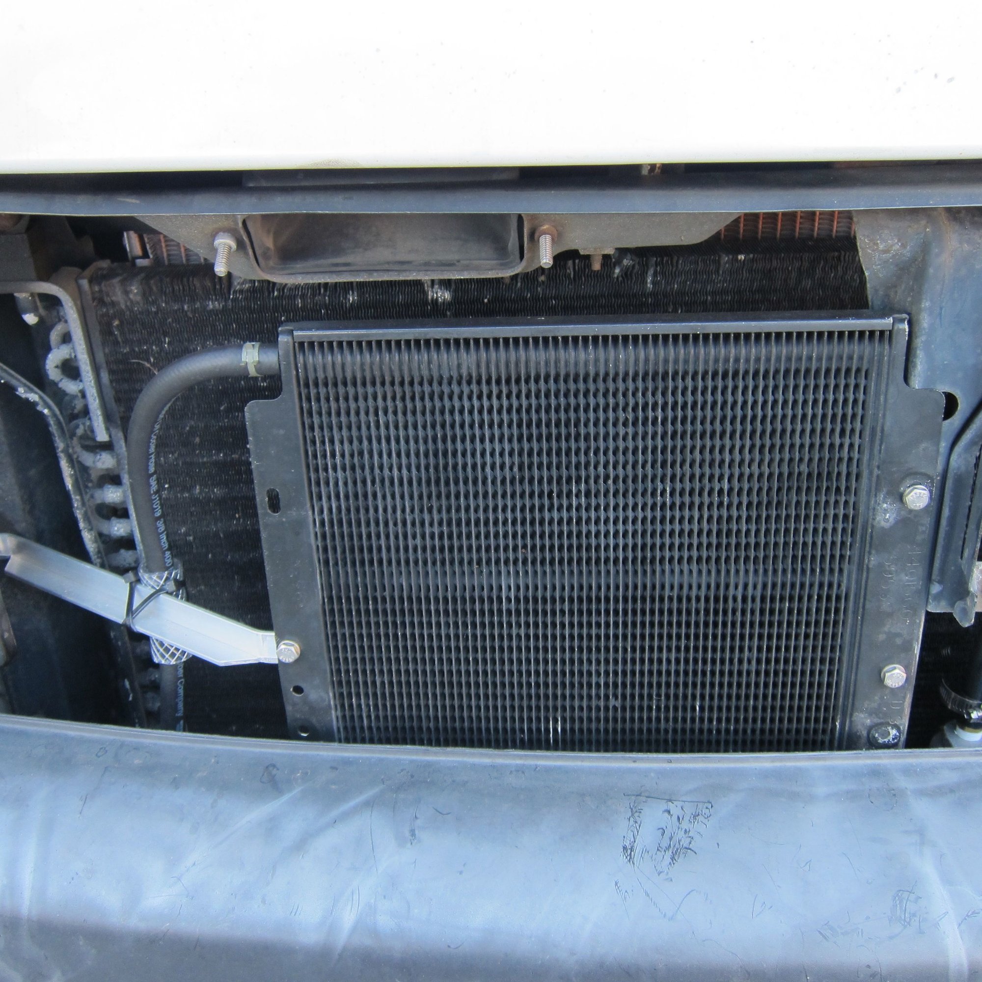

Default my set up
Sounds like you have your slipping issue addressed which isgood news. On the MagnaFine filters personally and this is just my opinion,great filters for power steering which is where I use them. For filtering andAutomatic transmission I prefer using a Wix 51622 filter with a cooler. The other brand well let’s just say a visit to BobistheOilGuy site should clearsthings up.
