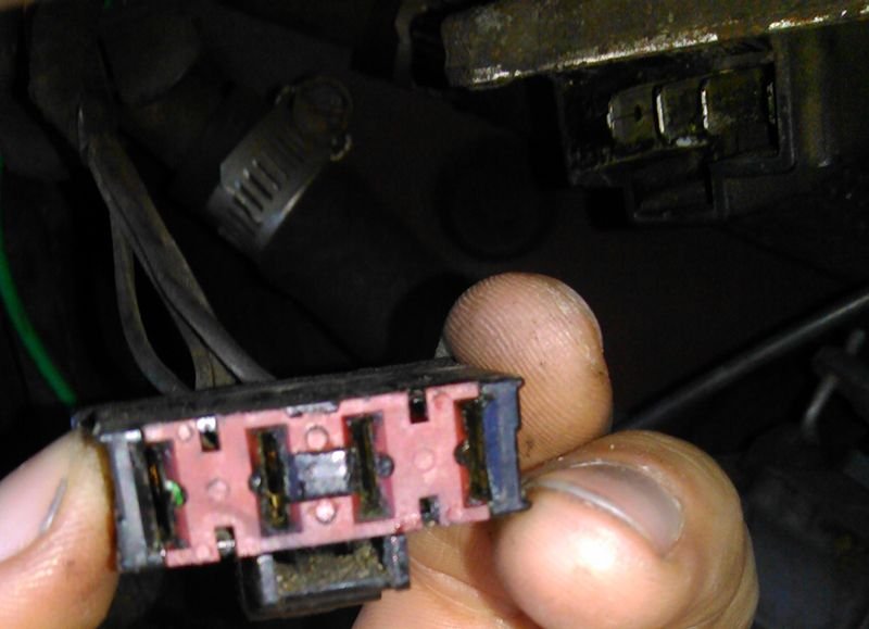

So I found the connections for the wipers and just tried some contact cleaner, and I also did the same for the blower resistor connections. Boom, everything started working great. I got all the speeds for the blower fan and the wipers. But of course, a few days later it all crapped out on me again. It seems that if I just move the harnesses around enough things will pop back on so I'm assuming there are just bad connections at points but I don't really know the best way to go about cleaning stuff up. Here are some pictures I took:
Blower Resistor Connection front(looks pretty good)
Blower Resistor Connection back(looks a little less good)
Blower Fan Connection(can't really tell anything about this)
Wipers Connection Front(kind of greasy in there)
Wipers Connection Back(looks bad)

In the 2nd photo the green wire looks bulged. If the wiring is full of corrosion I would cut it back get new connectors. I think the connectors are more readily available than they used to be.
