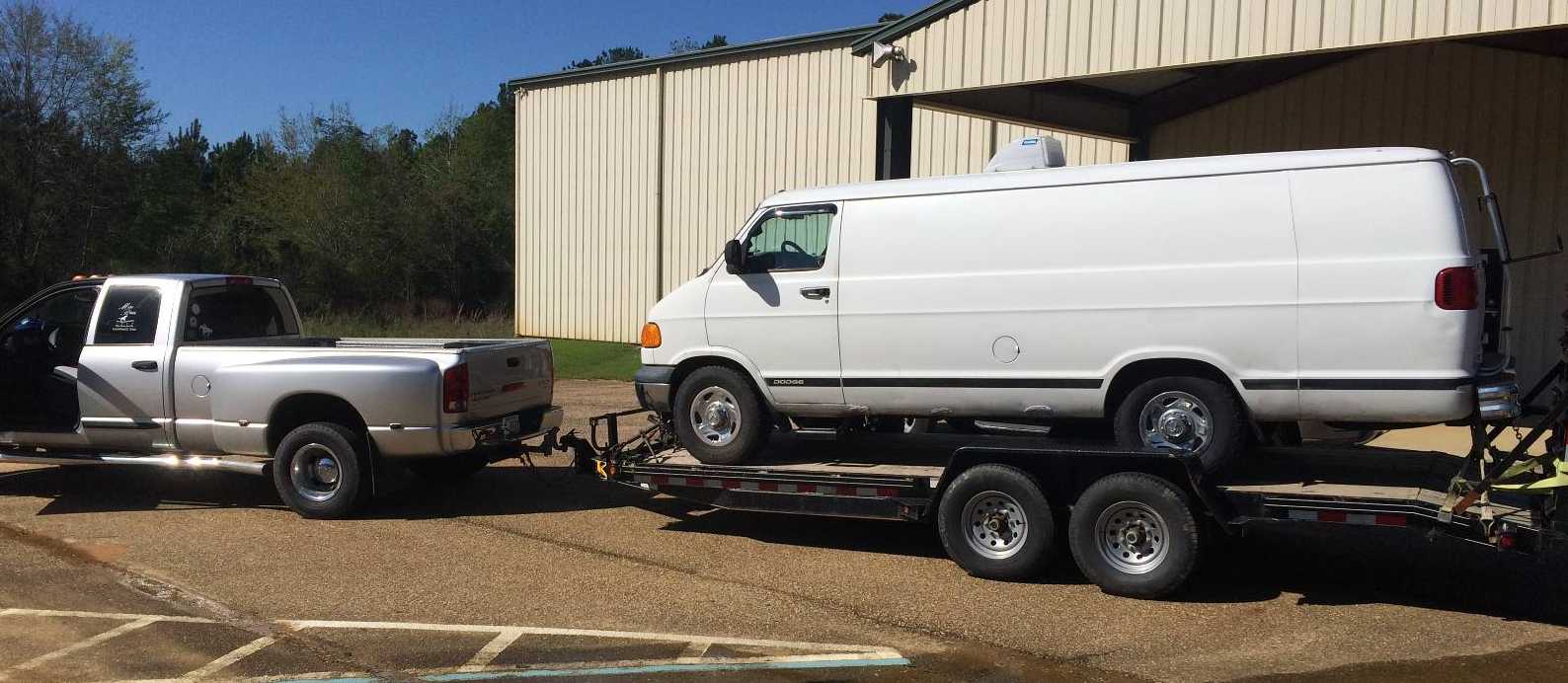

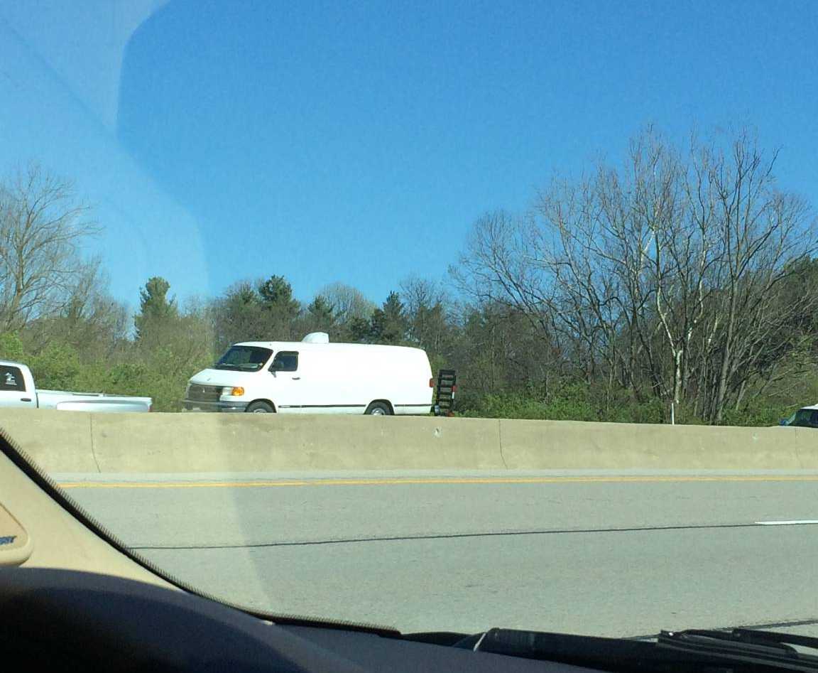

Left Friday to tow my van back from AL to my home in KY...
3 photos attached
1. in a rest area on my way
2. van loaded where I left it 8 days ago in church parking lot
3. near Lexington, KY where my daughter a passenger going the other way on I-75 snapped a picture
I got here without incident, 1701 miles round trip over 3 days.
2004 Ram 3500 dually Turbo diesel Cummins with 6 speed manual transmission and heavy duty 19' 8" equipment hauler.
I have a new found respect for that Cummins engine! That Dodge was a beast pulling up hills at 65 MPH in top gear! About 10 MPG average down and back.
