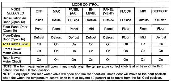

OK, you must carefully remove the top dash out. First take of the A-pillar trim. Then the side screws. Next take off the door house. Finally take off the front trim bezel around the radio, hvac controls, and the dash cluster. NOTE, when taking oof the dash cluster, you will need to shift to 1st gear. Chuck the wheels to prevent roll and leave the engine off.
OK, with all that said, you have all the inside access to the HVAC unit. The HVAC control head has a temp cable, a vacuum setup and electronic actuation. From here you can track down the problem.
HOWEVER, under the mini-hood, the HVAC is on the passenger side in the engine bay. On the web, I think Advance Auto or AutoZone has a parts diagram. The fresh air bleed door usually gets stuck and the access is from the mini-hood location.
Behind and under the passenger front wheel area looking up is the bottom side of the HVAC system. You will find the blower motor and the speed blower control rheostat.
