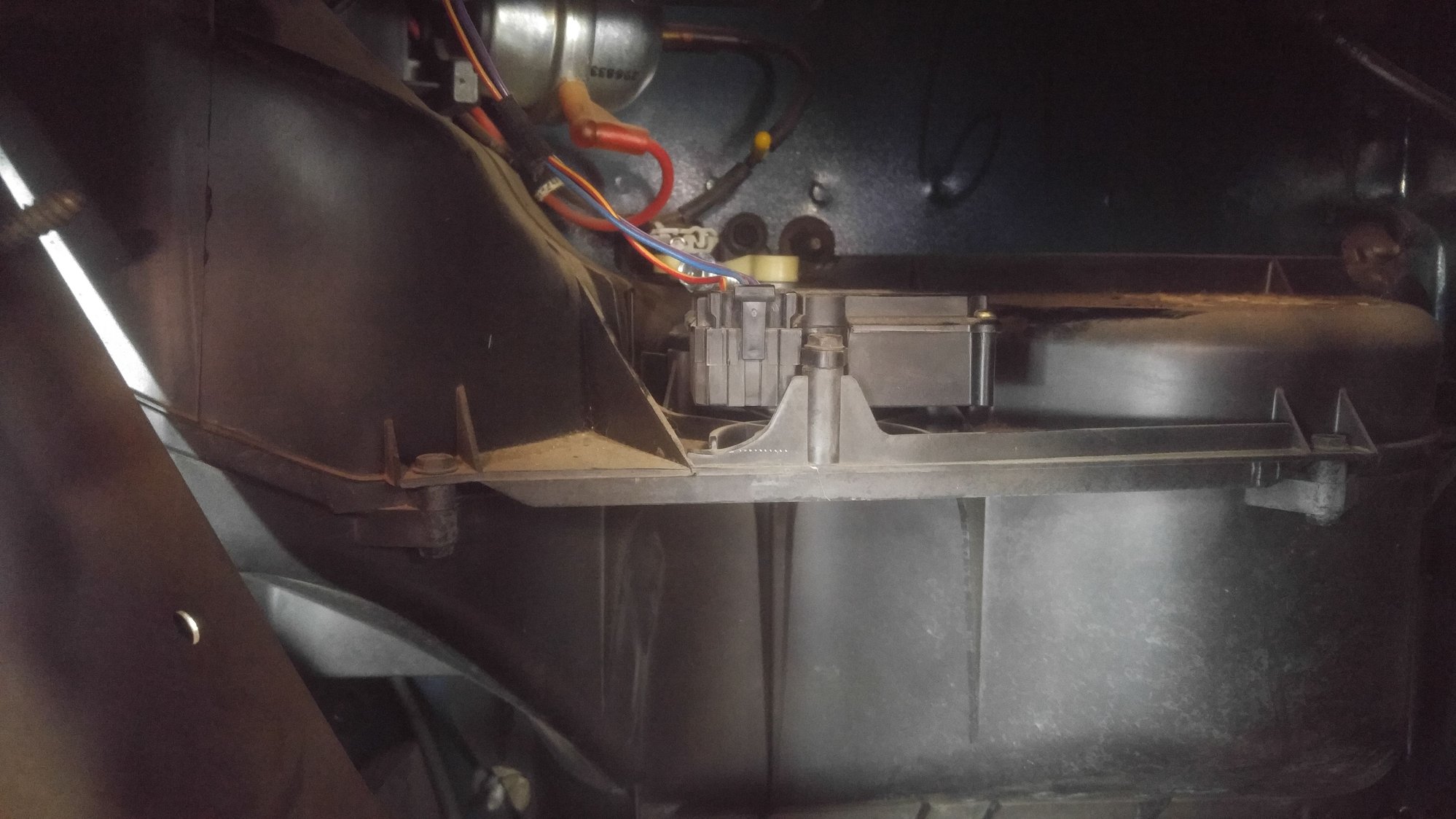

Thank you so much! I believe that is connected. There is a rod that goes through the firewall into the engine bay. That's the rod I pushed in to get the ac to work. On the glove box end of the rod is a connector that goes down into an electrical sensor or something. The valve with two or more connections is there and connected... If I have to I'll get a picture but I only have a cell phone.

It's in the middle of the picture and there's a silver screw wedged in there behind the wires. Not the actuator on the upper left hand corner. Is the motor that black box with the wires coming out?

I had an issue with my blend door.
I took it to a tech I know and the door internally was rusted and wouldn't move correctly.
Just wanted to let you know. I had similar issues but I found this when my heater core leaked.
Yes, that is the blend door motor. As you turn the temperature dial up and down that motor will rotate and move the blend door linkage.
