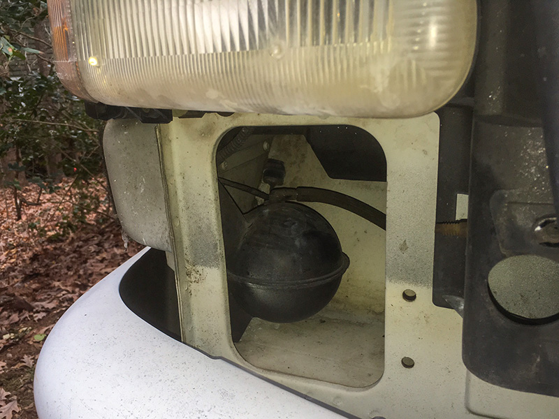

I’ve read through a lot of material here and it’s been helpful. I found the vacuum chamber behind the R headlight and traced the vac line to the intake manifold. The hose looks OK, but I will replace it while I’m in there. Do you guys still think it’s this vac line or have you heard of this “flap” closing within the dash caused by something else?

I fired it up last night to confirm if it was blowing better from the defrost vents than any of the others but it's not any different. With that info, I'm hesitant to chase the vac issue as THE issue. I still think its a clog in the plenum.
