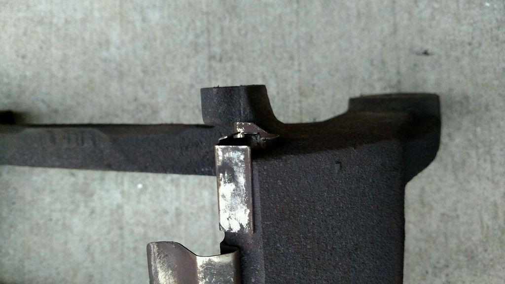

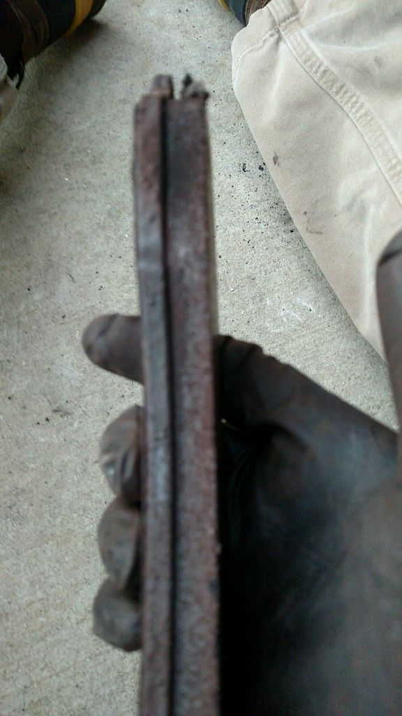

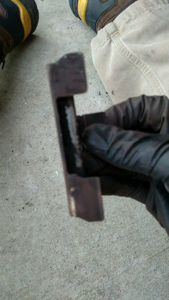

So I have a noise coming front the front passenger side brake. It goes away when I press on the brakes. Thought I was due for pads. Took the tire off and caliper and the pads are fine. The shim that the pads slide on, one shim rubs the rotor. Both shims are able to slide back and forth about 1/8". If I slide the one shim making contact over the sounds goes away. Not sure for how long though, I guess until it vibrates back.
Anyone have experience with this?

It's definitely the shim. I took it off today, trimmed it back a little. No noises at all.
