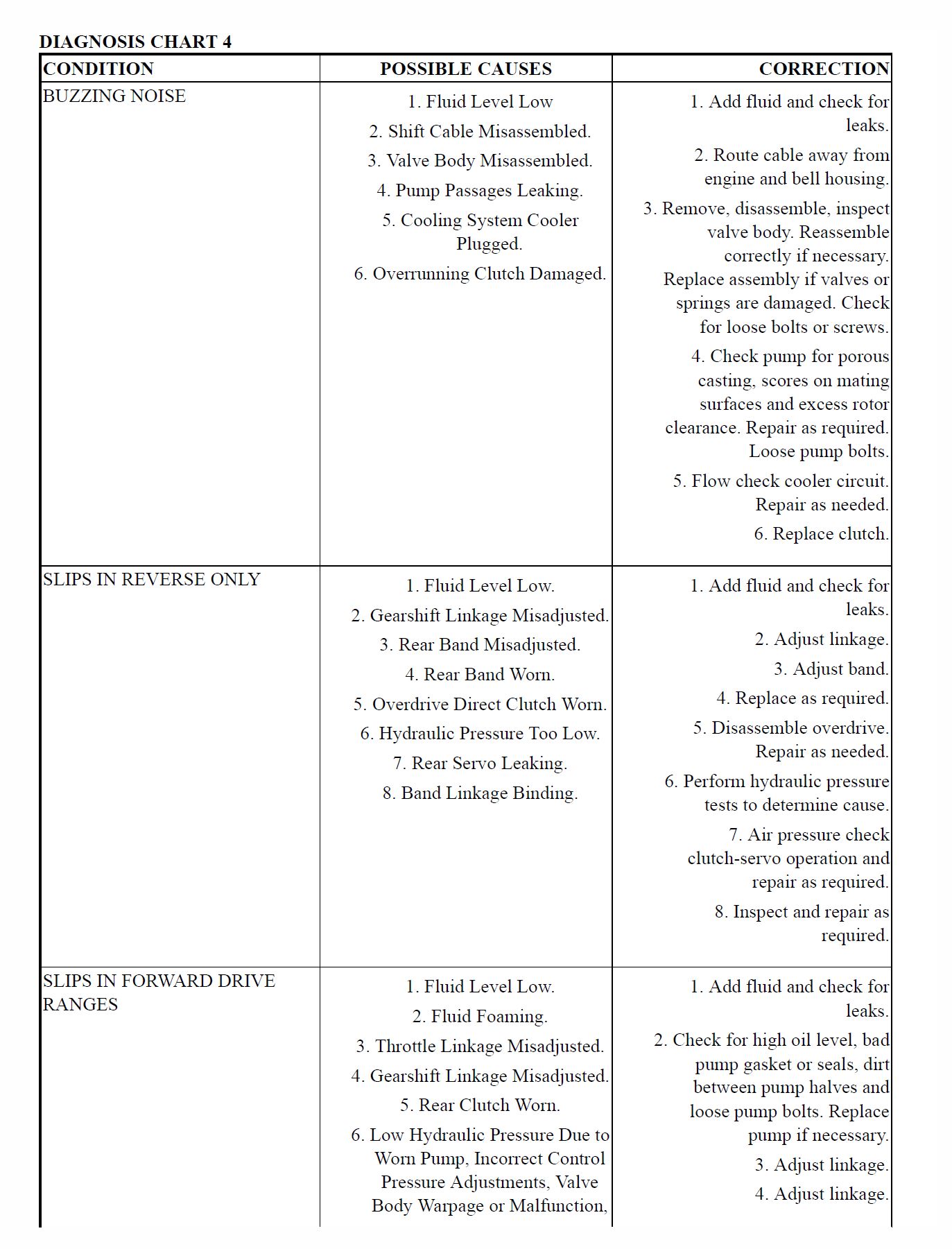

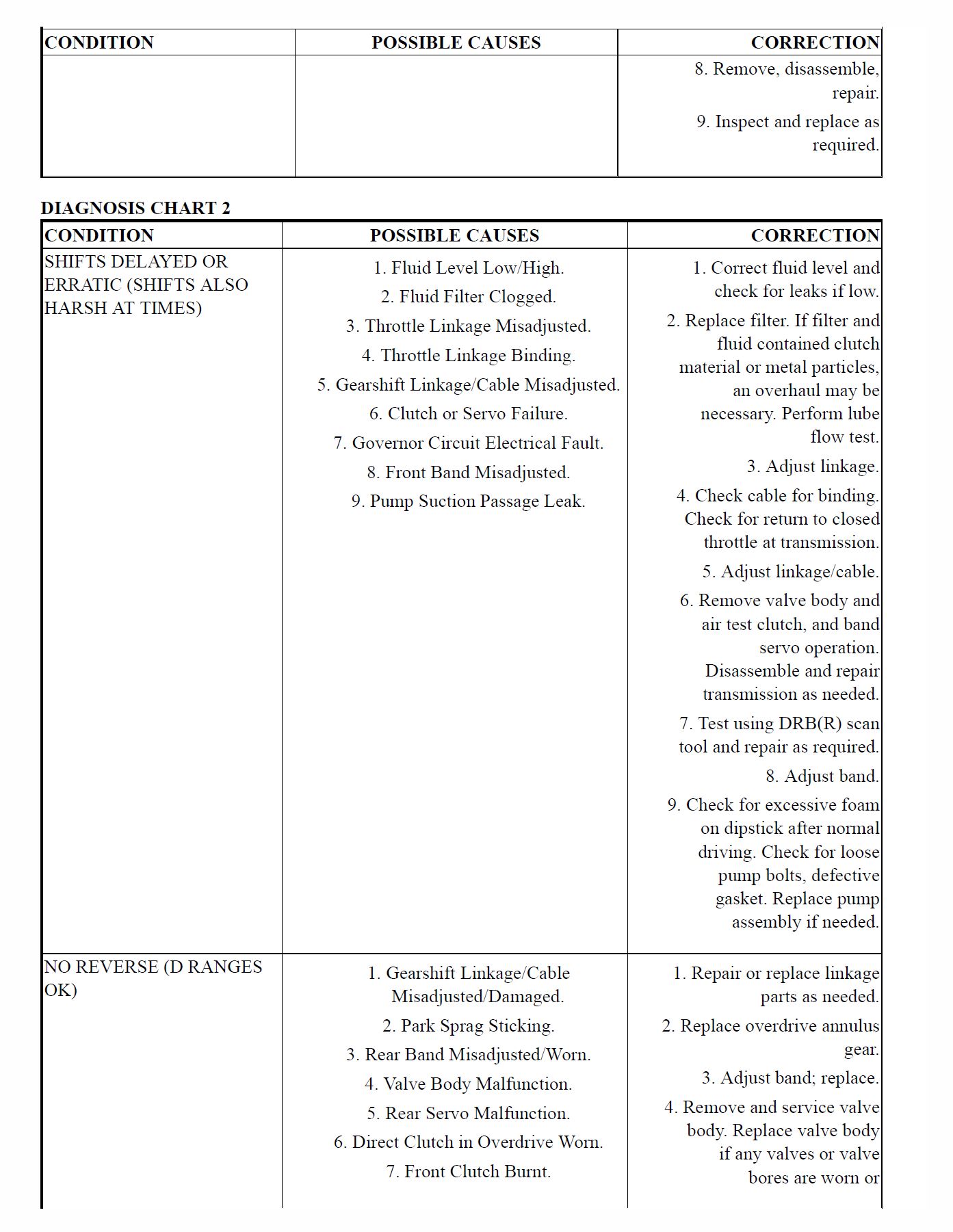

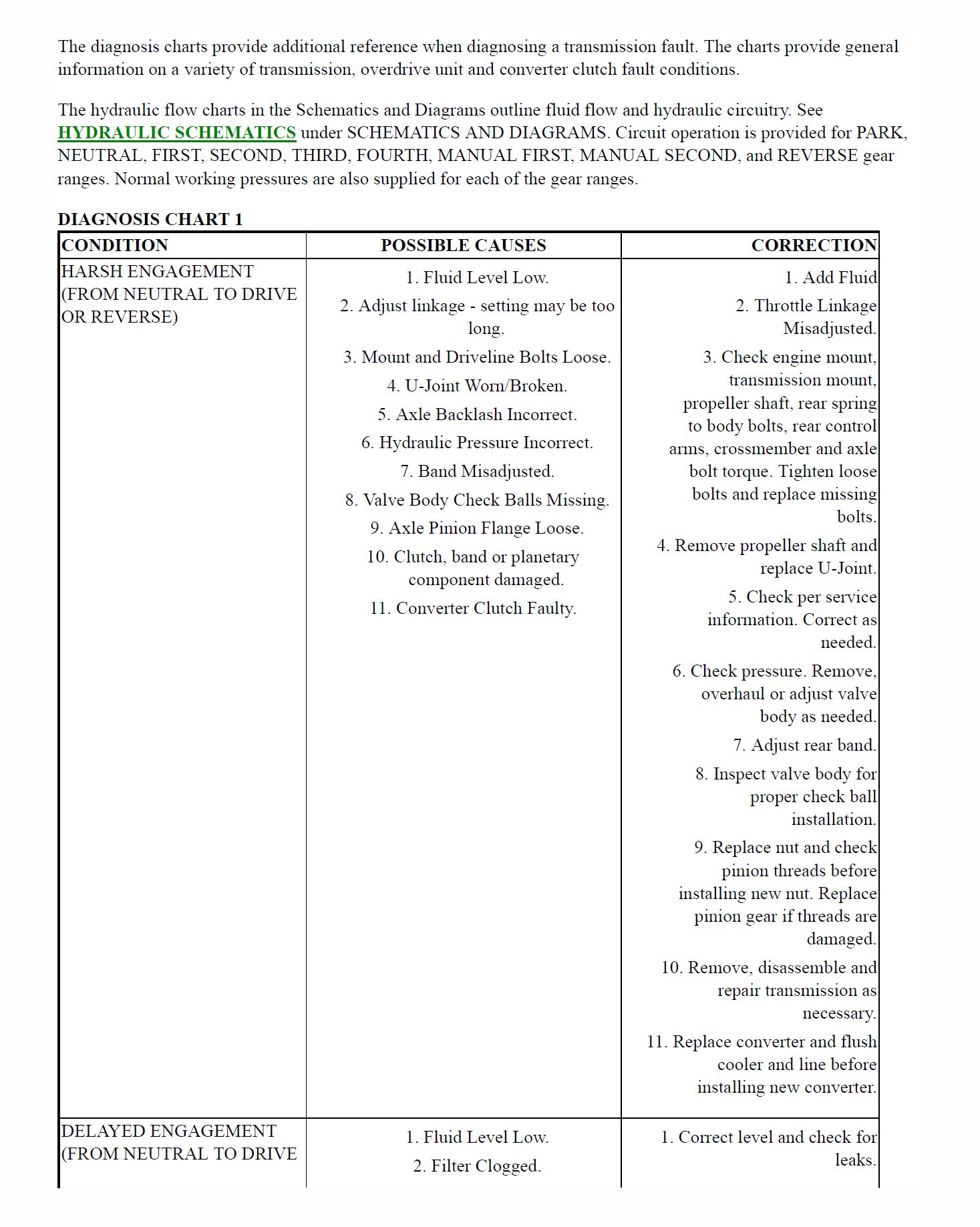

Here goes. I just bought a 1992 Dodge B250 cargo van. It has the 5.2 L (318) with over drive tranny.
my problem is it don't shift correctly. It won't go into
2nd in the morning until it warms up. Then it shifts
Sometimes​ correctly and other times it shifts so hard I have to go to the chiropractor! Is this an indication of incorrect fluid? Fluid is clean, not burnt
Smells fine. Time for replacement? Band adjustment? I ain't no tranny mechanic by trade for shore! Any advice would be great!

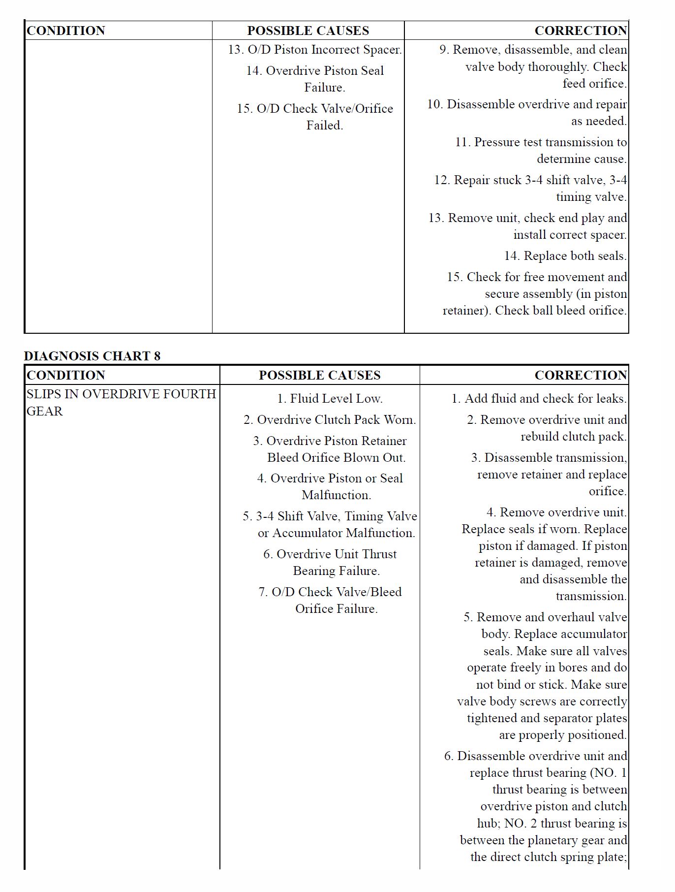

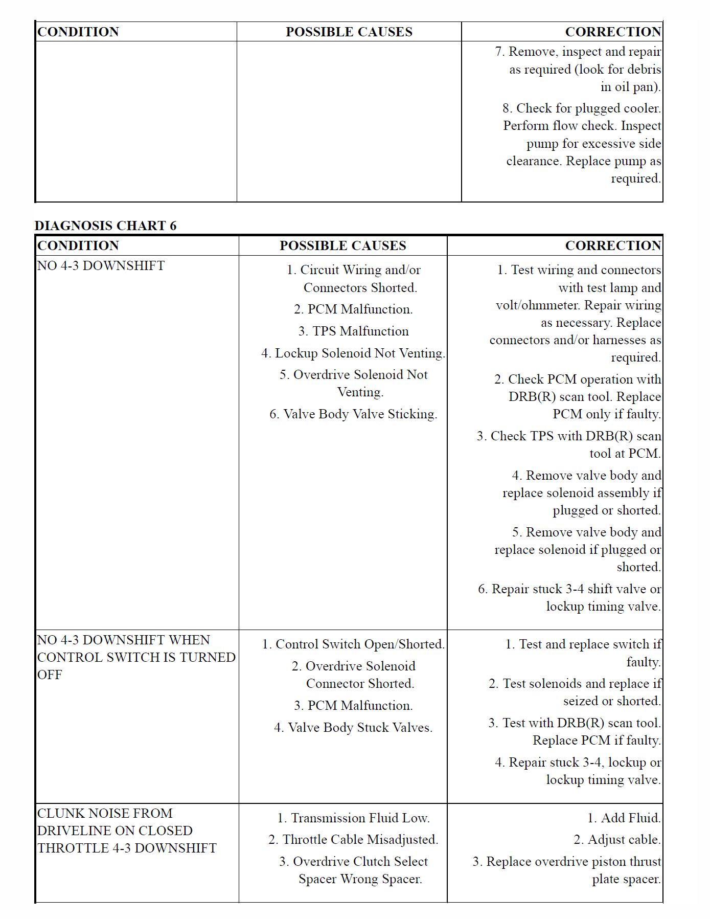

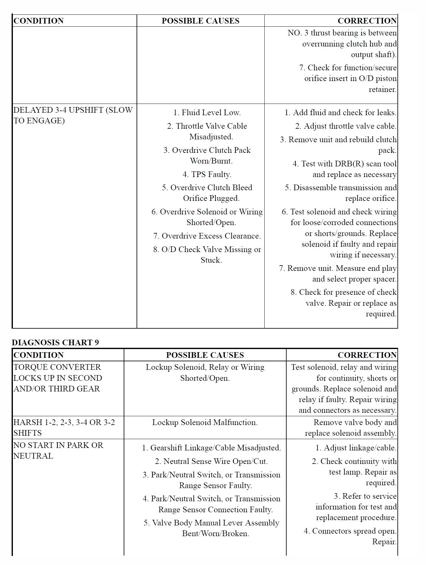

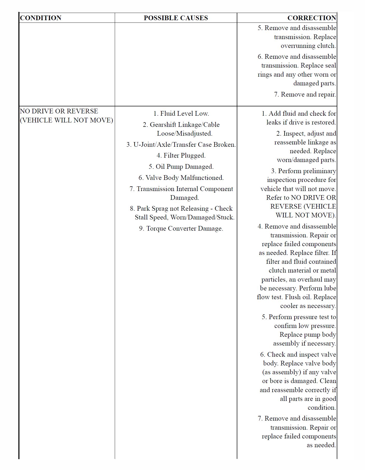

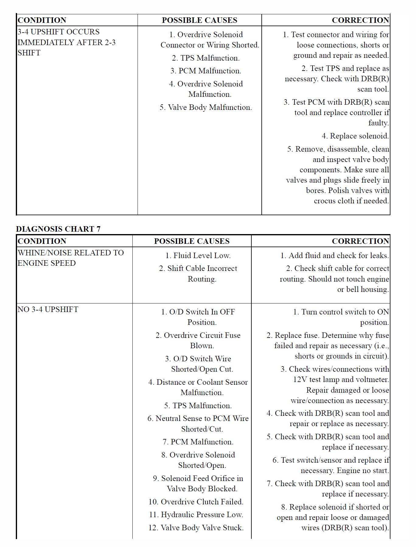

This should help
Attached Thumbnails YO! Need a little help here!! Transmission issues-1.jpg   YO! Need a little help here!! Transmission issues-2.jpg   YO! Need a little help here!! Transmission issues-3.jpg   YO! Need a little help here!! Transmission issues-4.jpg   YO! Need a little help here!! Transmission issues-5.jpg
YO! Need a little help here!! Transmission issues-6.jpg   YO! Need a little help here!! Transmission issues-7.jpg   YO! Need a little help here!! Transmission issues-8.jpg   YO! Need a little help here!! Transmission issues-9.jpg   YO! Need a little help here!! Transmission issues-10.jpg
YO! Need a little help here!! Transmission issues-11.jpg   YO! Need a little help here!! Transmission issues-12.jpg   YO! Need a little help here!! Transmission issues-13.jpg   YO! Need a little help here!! Transmission issues-14.jpg
