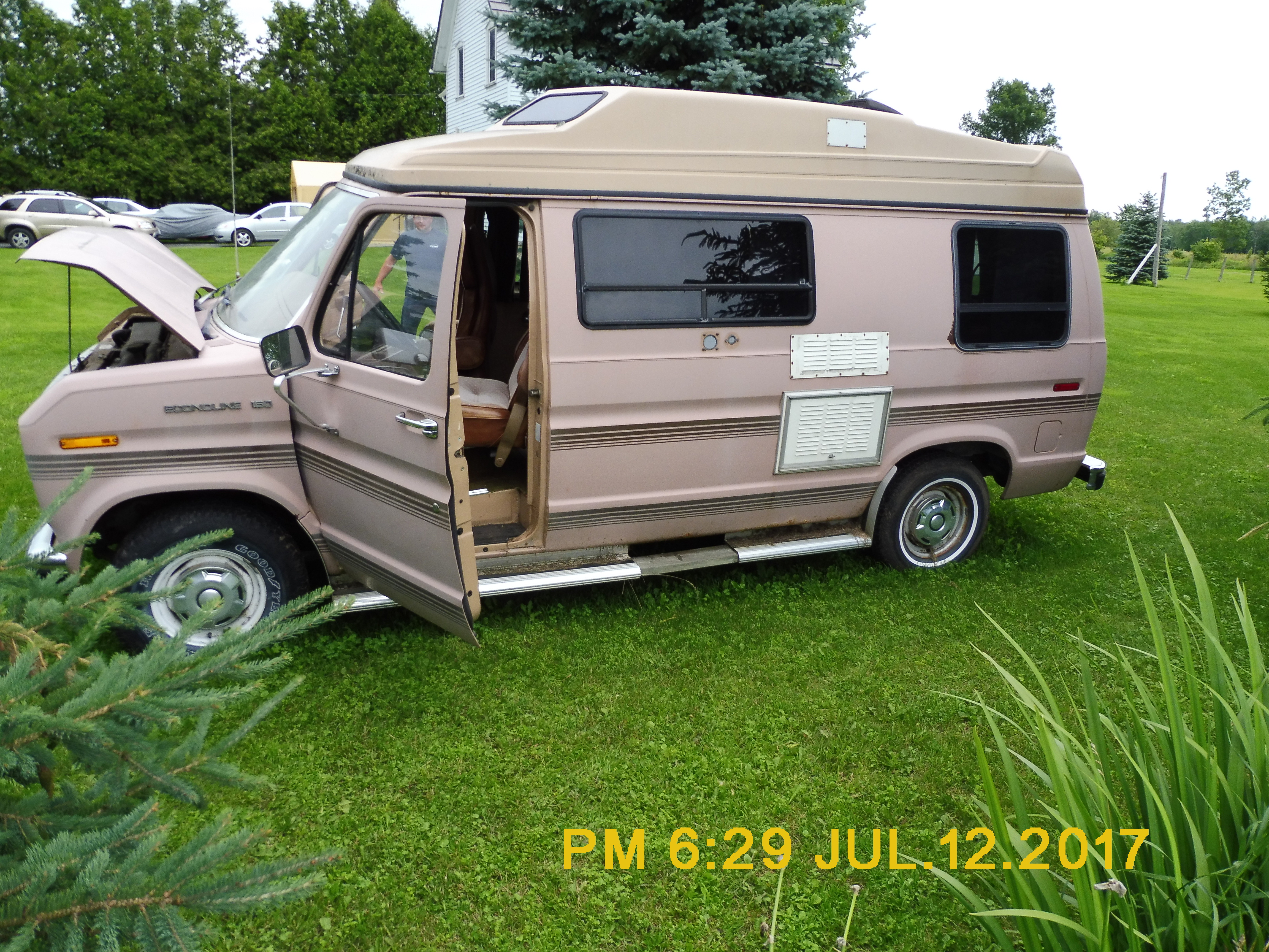

Use a body line to follow rather than trying to figure out "level". You just cut the hole, paint the bare metal, and caulk it in. You can see in the attached photo of the van I just bought that it will rust around the window if you don't paint the cut. I bought the van for the driveline for a car I'm restoring so the rust doesn't matter...
