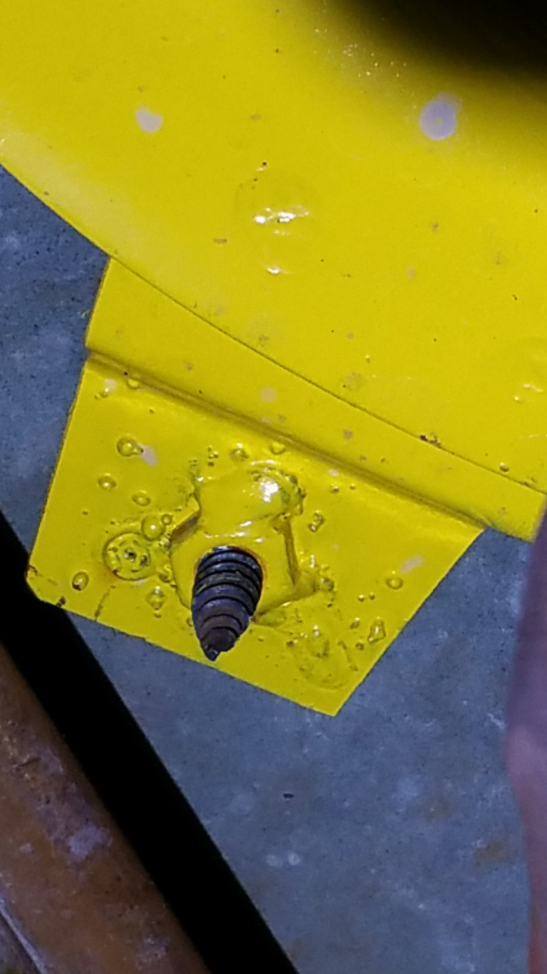

The bolt clips on my 1996 exhaust shields wore loose and rattled. I welded a couple of hex nuts to the underside of the shields. That allowed me to torque them tight -- no more rattle. Perhaps this could work for you.
