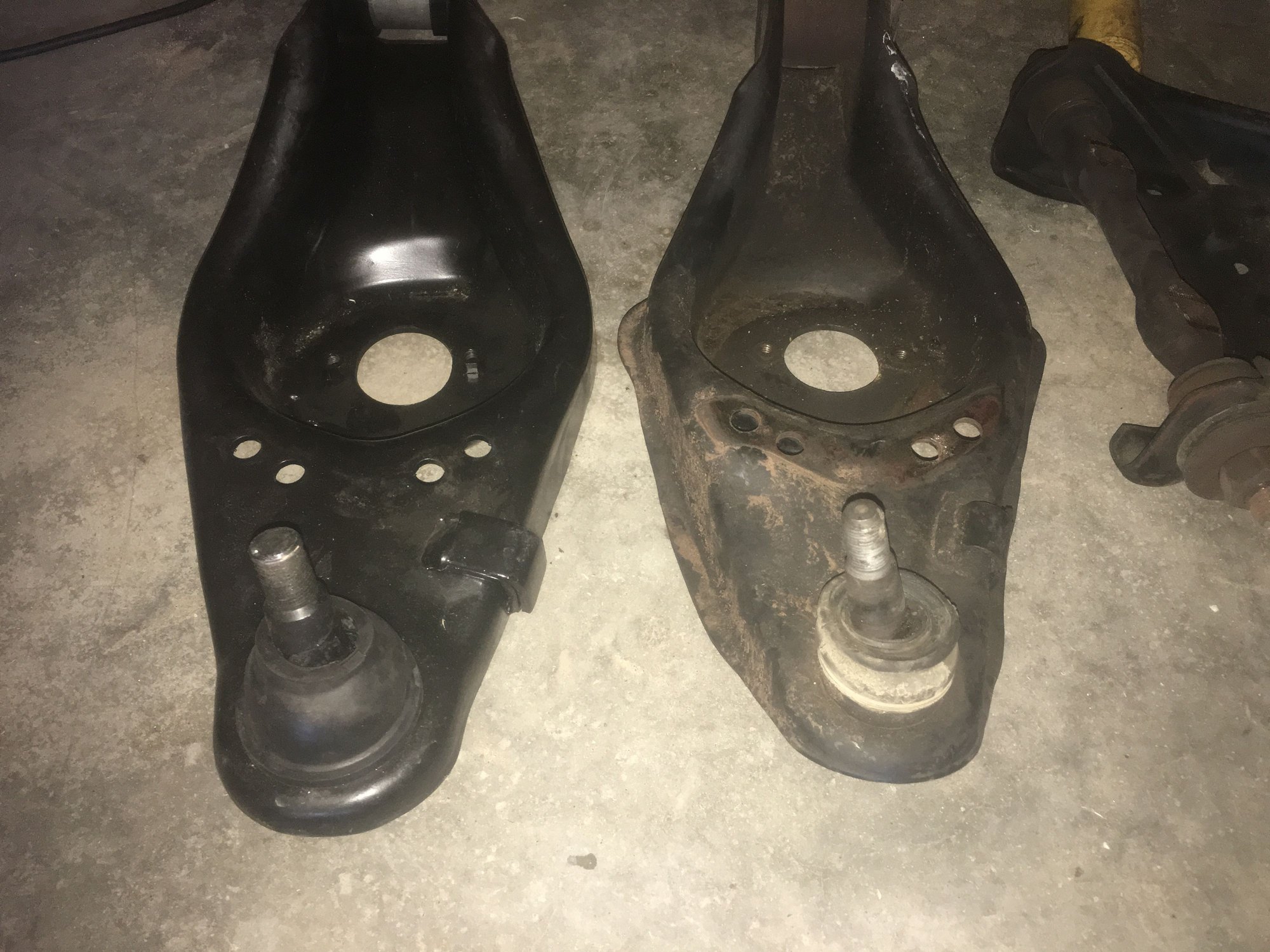

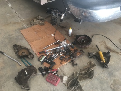

Decided to tear into this project today and after a quick disassembly of the right front, the supposed 3500# lower looks more like the 4000# arm shown in most catalogs...
4 holes drilled to accept either right or left side strut arm...
Let yall know when I do...

There are definite and obvious differences!
1- Larger lower ball joint on the 4000# arm will not fit the 3500#
2- Different arm design, more pronounced curve to the arm where it attaches to the frame.
Even contacted Summit and Rockauto techs and asked if they would interchange and both responded with same answer. They both said the arms would interchange according to part descriptions. WRONG!
Oh well, I will take this hit for all the other guys that may encounter this issue in the future.
Gonna have to return the 4000# arms and re order the 3500#...get charged for return shipping and the 3500# arms cost double the amount...
And BTW, FYI... so far both MOOG and Dorman are made in Copylandia.
pics of the 4000# arms next to the 3500#
Arm angle is different, ball joint bigger
Bigger BJ on the 4000# (left) 3500# on the right
Here you can see the angle difference
4000# (left) 3500# (right)
