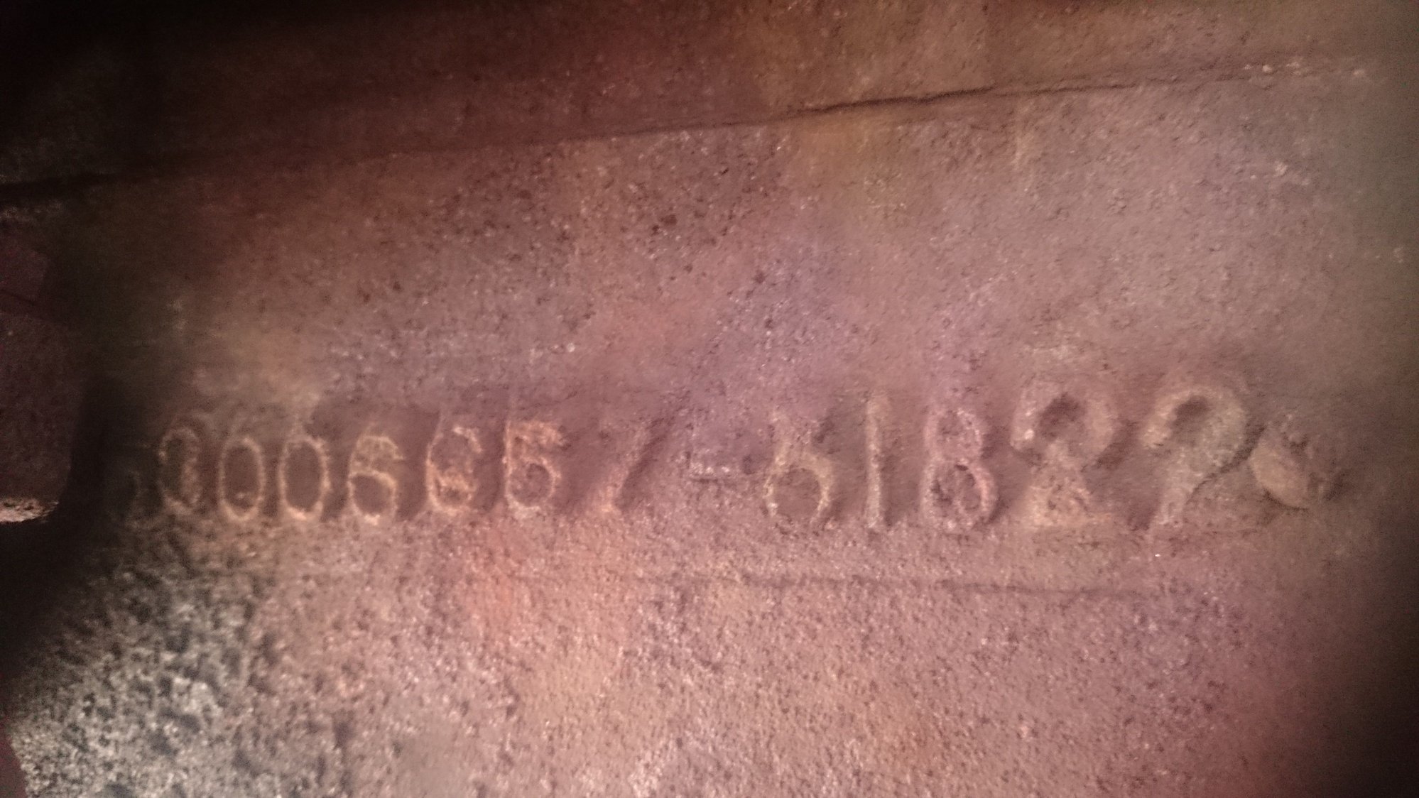

Can anyone tell me wich year my engine was build? I want to know this because i want to order parts. For the casting numbers see the picture.

Engine casting of my 318 with TBI

Hi there, the chassis is from 1978 and i was told that the body is from 1980.
I was told that the engine is from 1990 but i am not sure. It has TBI and the engine casting number is shown in the picture.

I'm having trouble making out some of the numbers. Can you either wire brush the numbers to be cleaner and post a new clearer picture, or just write them down here since you can probably see them better in person.

Default Engine casting 53006657
Originally Posted by alloro
i'm having trouble making out some of the numbers. Can you either wire brush the numbers to be cleaner and post a new clearer picture, or just write them down here since you can probably see them better in person.
53006657

Originally Posted by Panzerfaust
53006657
It's a 1991 318 C.I. or 5.2L V8
Original engine VIN code would've been a Y.
Scroll down this page to the 1991 section for a description of the difference with your block.
http://www.mopar1.us/sort.html
