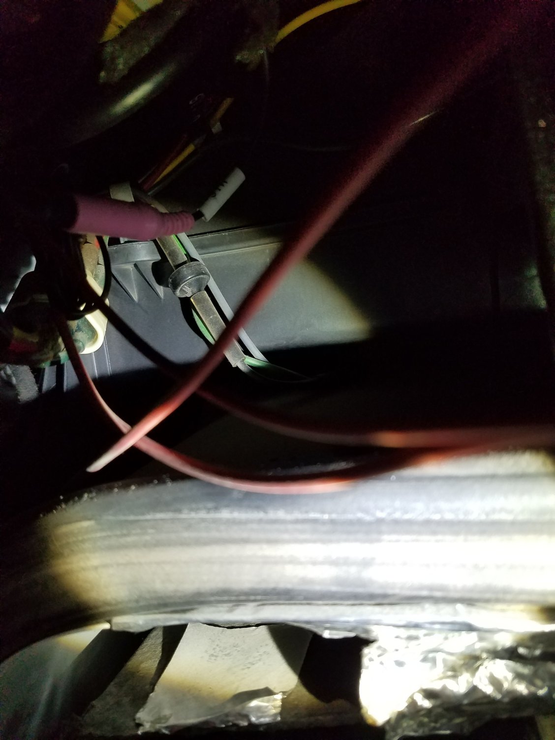

So it looks like the 2nd check valve is behind the HVAC controls. I removed the doghouse and it sits right above. See attached picture. Mines a 2001 with the 5.9 motor.

Widebody according to Moparfanatic21 in the 2nd generation Ram forum the new larger check solved his problem with the vents. He stated that changing the check valve with same one did not work. The fix is the larger check valve.k Thanks for posting the pic. My new check valve should be here sometime this week.

I ordered the new check valve in your link as well. It must have a small reservoir that holds vacuum as well. I couldn't remove the check valve shown in my picture. I sprayed some silicone spray and hopefully that loosens it up by the time the new check valve comes in. Hope this does the trick

I replaced in the same spot the existing 2nd check valve was located. I had to remove the doghouse just like you. On our model of van you could not access it through the HVAC controls, you have to remove the doggy house. Mine was located in cluster of lines running to vacuum modulator that controls the vent airflow positions. You will need to pickup some hose fittings to adapt it. You might want to take to auto parts place and let them help you with the fitting of it. I hope it will solve your problem as it did mine. Good luck to you.

I just wanted to report that I ended up replacing the existing 2nd check valve behind the HVAC controls like the original poster did, and my wild vent is finally fixed. I highly encourage anyone with the same problem to do this simple fix.
