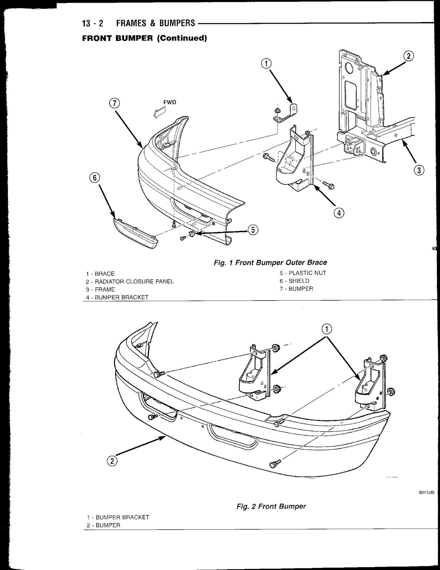

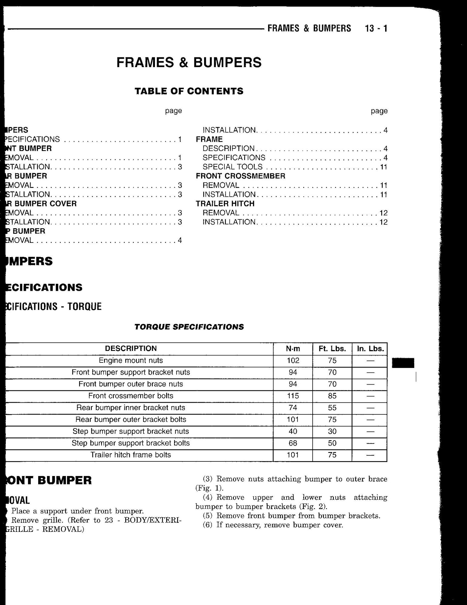

Sorry for the lousy scans but they might help
