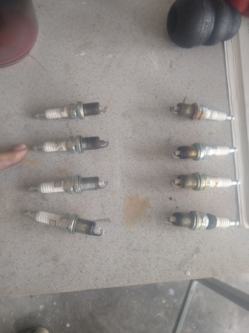

Here is another pic of all my plugs. You can see the cylinder 3 plug (where my finger is) is the only one that is dark. Weird thing is, cylinder 2 (top right) looks like it has some water damage with the rust showing, but whatever.
Thanks all. Could the issue lie in my injectors or fuel rail? But wouldn't an injector issue make it run lean not rich? I dunno just throwing stuff out at this point. I couldn't do a compression test since my tester wouldn't fit. So, i'm kinda stuck right now. Lemme check the gap.

So gaps were fine. I replaced the plugs and will be test driving it soon. Crazy thing is I noticed a leak at my exhaust manifold. Wonderful.
