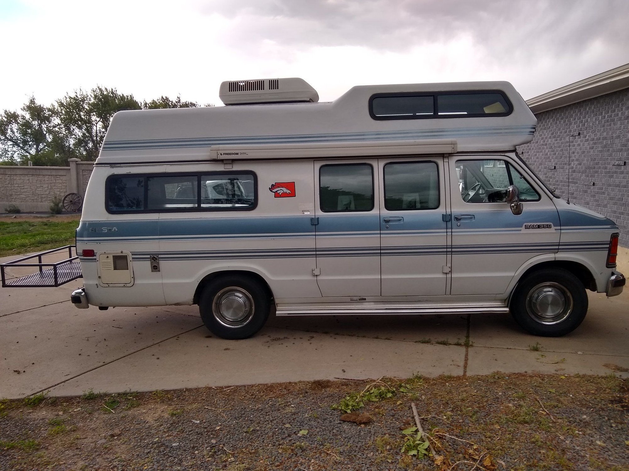

First winter for my van. Is it ok to blow out the water lines with a compressor and not add that pink fluid? I removed toilet and capped black sewer line, capped water line that was used to flush toilet, and will never use the shower. Basically, all I have is running water in the kitchen sink, hot and cold. I know if have to drain the hot water tank. There is a black tank and a grey tank, black tank no longer used. Appreciate any assistance!
