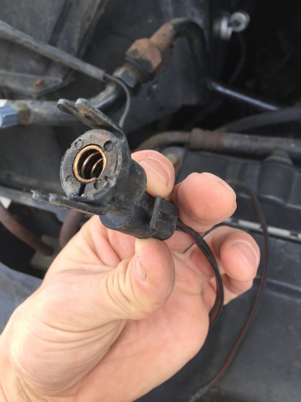

Found this hanging loose under the hood near the AC compartment. 1994 B250 Camper Van. Anyone know what it is? Thanks!

The plug looks like it ends at your finger tips and the rest is a sensor of sort. Where in the engine compartment is it located?

Oh yeah, you're right! The plug was hanging to the right of the engine compartment, under the hood, facing the van...

Then I'd say it's the battery temperature sensor which I believe fastens to the underside of the battery tray.
