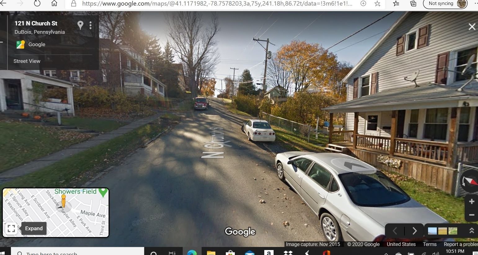

Ive noticed an issue with my 02 1500 5.9. When going up severe slopes...ones that are 20% grades or more (Im estimating )
the trans will pop out of gear. I think it is fluid starvation. The fluid level is about right too. It has only done this a few times...
Is that what is going on?
Here is how steep it can get - and this isnt the steepest
