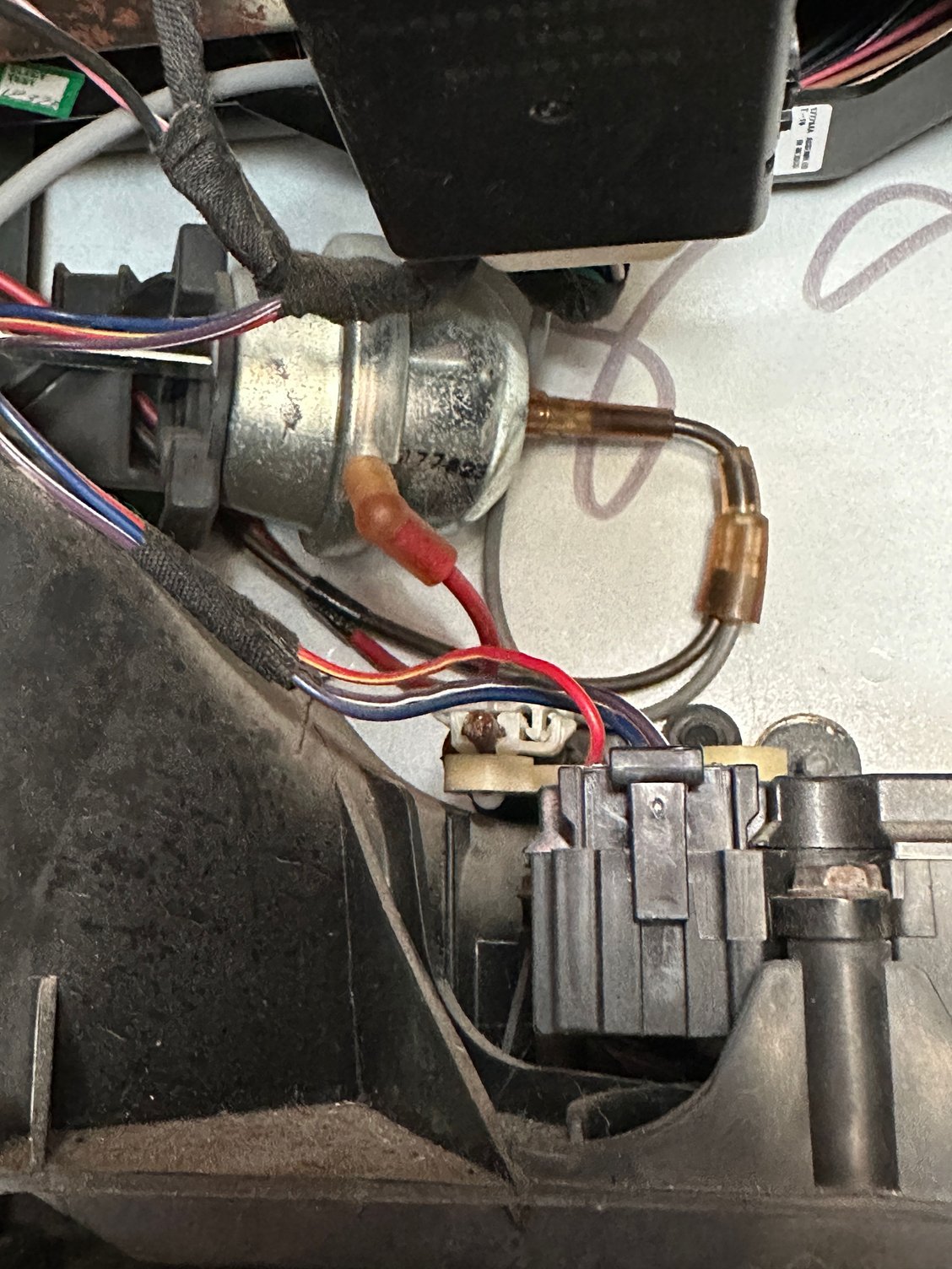

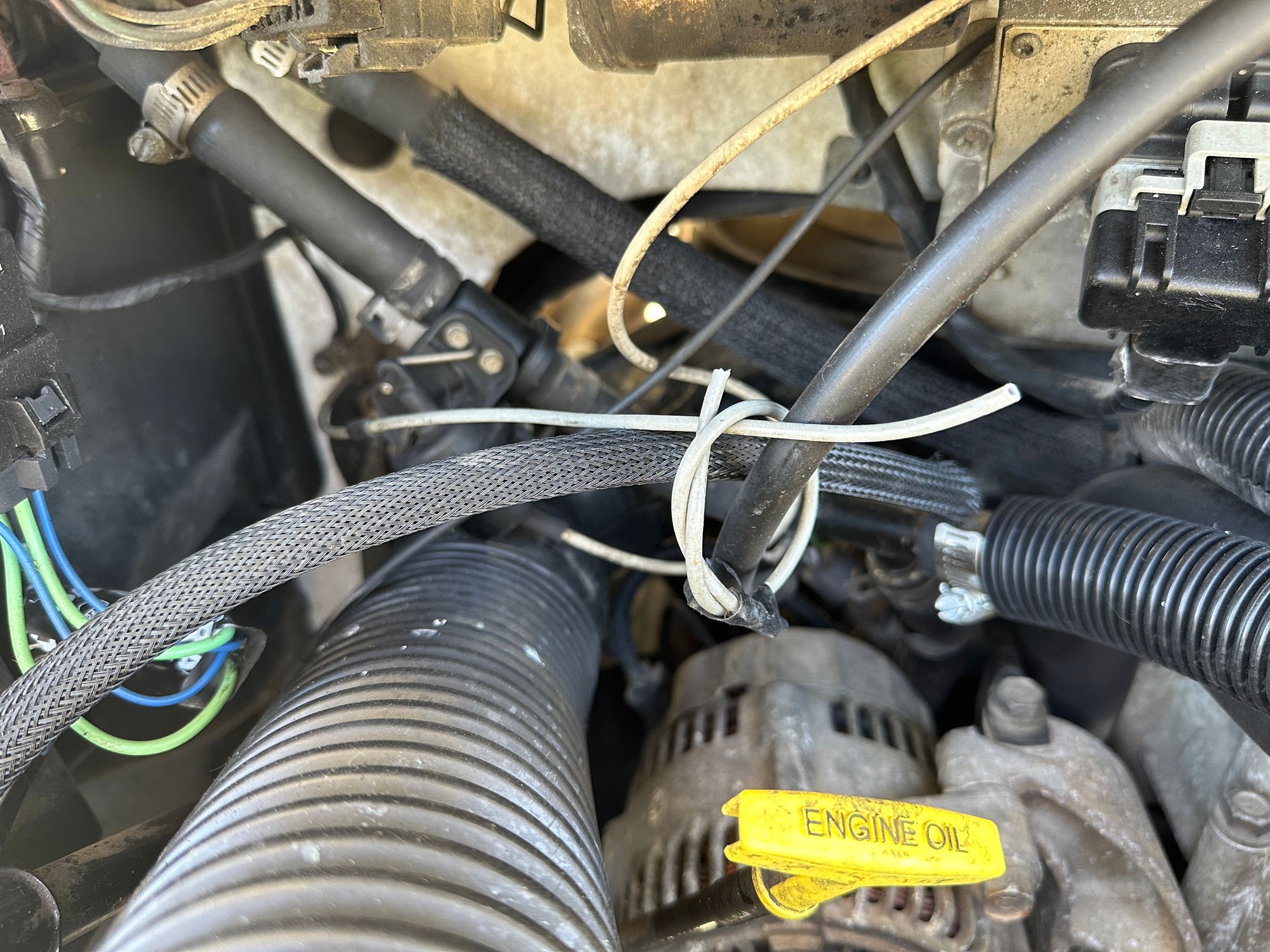

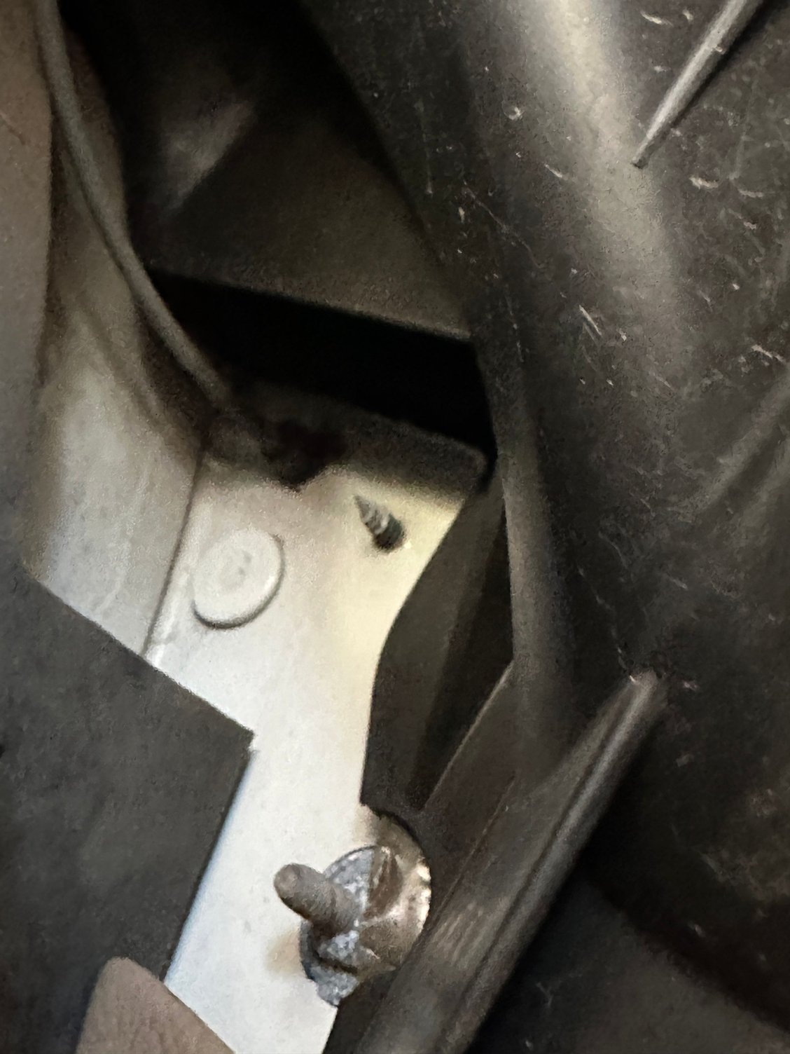

so, despite the 100-degree California heat, I decided to tackle the issue with the air vents and I think I found the issue...I think
Looking at the pics I took, there is a grey vacuum line that connects to the vacuum control valve (not sure what to call that metal housing)? that isn't connected to anything. It's super brittle and snaps if you so much as look at it. Any idea where it should actually connect to?
red line on the side, black and grey connected together and into the end (looks like this is how they should be due to the matching connector)
grey line passes through the firewall
comes up from the firewall and goes.....nowhere
Judging by the tape around it, I'm guessing the previous owner didn't know where it went either and simply taped it up. If I can figure out where it goes, and find a place that supplies replacement line, I might be able to survive while driving the van!

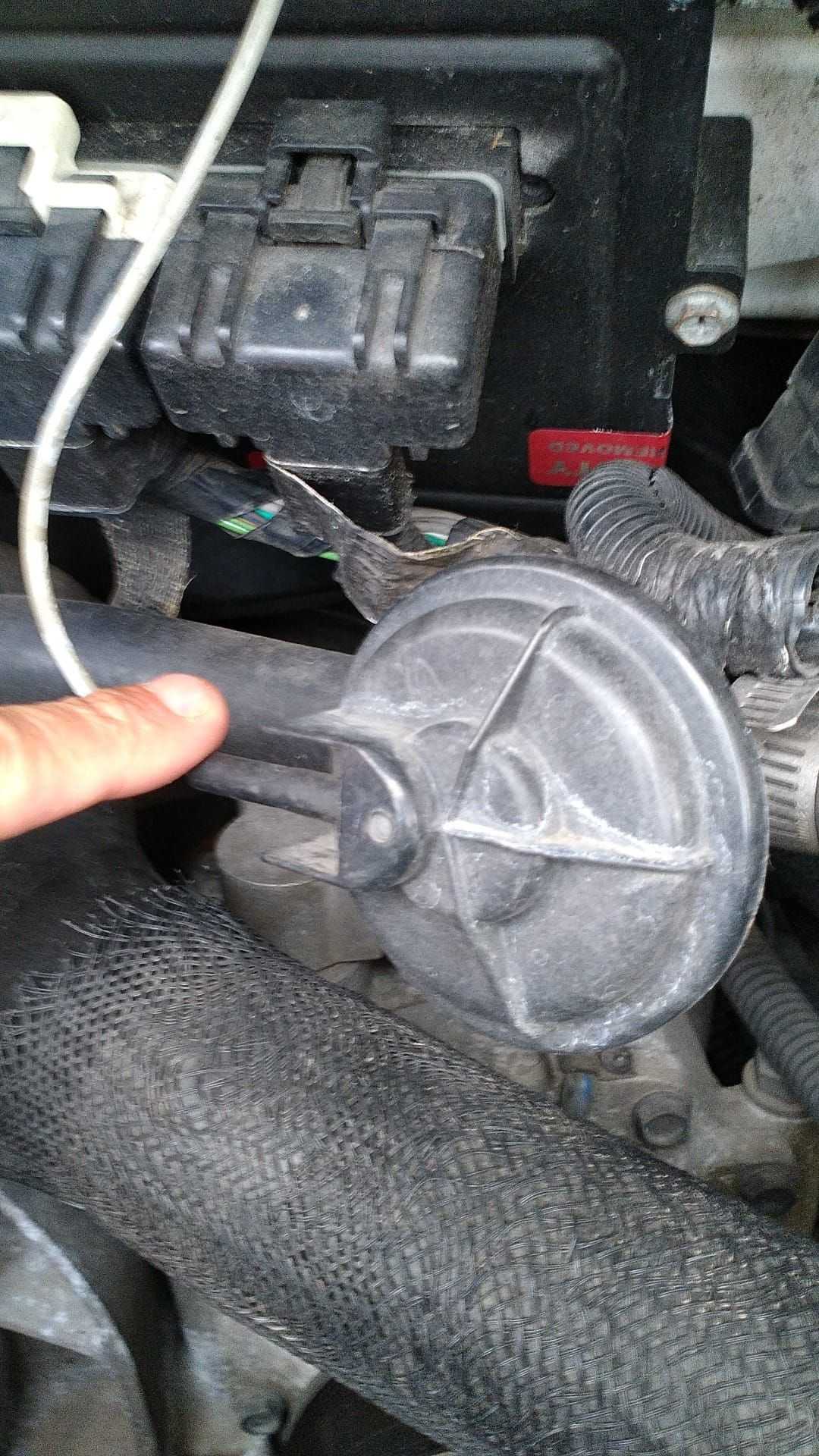

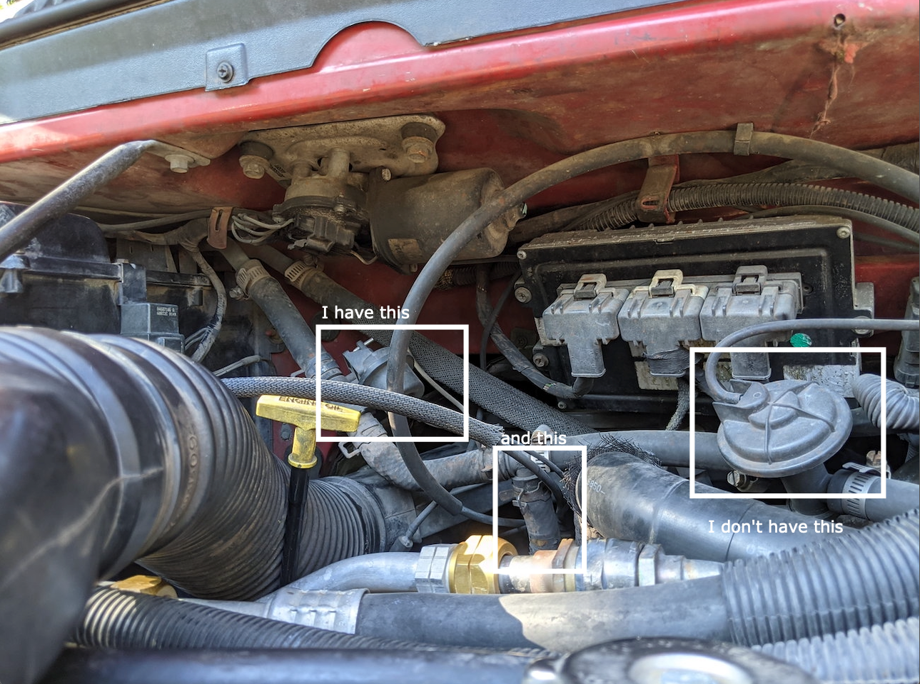

aha...I may have found the issue....or not
In my earlier post, I showed an image of a grey vacuum line that goes nowhere because it has snapped or become disconnected. In a Facebook post, someone advised that the grey line goes to this unit (see first pic)....but...see second pic...I don't seem to have that unit. The two hoses have been joined together via a connecter.
So
1) what is that unit called
2) any ideas where I might obtain one (assuming they're discontinued)
3)....er...nope..that's it I think. If I can get one and it fixes my issue...all good.

That has to do with coolant flow to the heater core. Just plug the line and see what happens.
Usually that vacuum diaphragm is located further back and it looks like you have a splice there as well.

I've compared my engine bay and components to that of others that have sent pics.

I have the valve on the left. Maybe I missed it, but I'm guessing you have rear heat.
Reply 0
Jul 31, 2023 | 04:48 PM
  #40
yes, I have rear heat also (conversion van)
