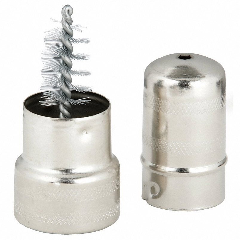

Clean the battery posts and the terminals with one of these.
Then spray some terminal protector on them.
