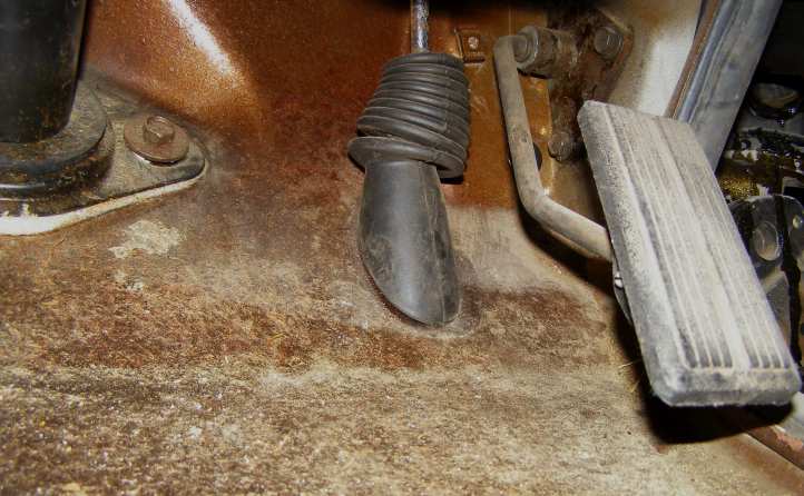

Here's a pic of the floor of my '87 model...
As can be seen, if it's the same as this there'd be an oval-shaped plug in the floor just ahead of the accelerator pedal in line with the steering column.
Is the 1990 model the same?

If the manual transmission was an option in that chassis I would highly suspect there is some type of plug/plate that can be removed. If not, nothing a hole saw would make quick work of in more ideal locating.

Unfortunately, I won't have a hole saw at my disposal, at least not in the immediate sense...
I pick up the van and start driving next Tuesday, right now I'm in Queensland and such equipment isn't the kind of thing you carry with you on a plane. My own van was built as an automatic and I fitted the manual transmission stuff from a slant 6 powered B100 or similar. The hole was there and it must have had some kind of plug in it, the problem is I don't know if that was still the case on the 1990 model.
I'm pretty sure there was a manual transmission available on this model, but I'm thinking it had the hydraulic clutch. If that's the case, a blanking plate somewhat higher on the firewall is quite likely.

So I did a little looking, it appears the 3.9L V6 was optional with a 5spd manual, but the V8 was not. My information isn't 100% obviously however being it was an option in the chassis I would expect the provisions to be there unless they made a completely different body for the V6.
When looking up the clutch linkage is lists master and slave so it would appear that it is hydraulic also as you suspected
My information is all USA biased as well, never know what Dodge was willing to export to other countries and not offer us. They did enough of it in my opinion.
