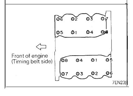

Im looking for a headbolt sequence chart for a 1992 stealth es N/A dohc. thanks

pic attached
