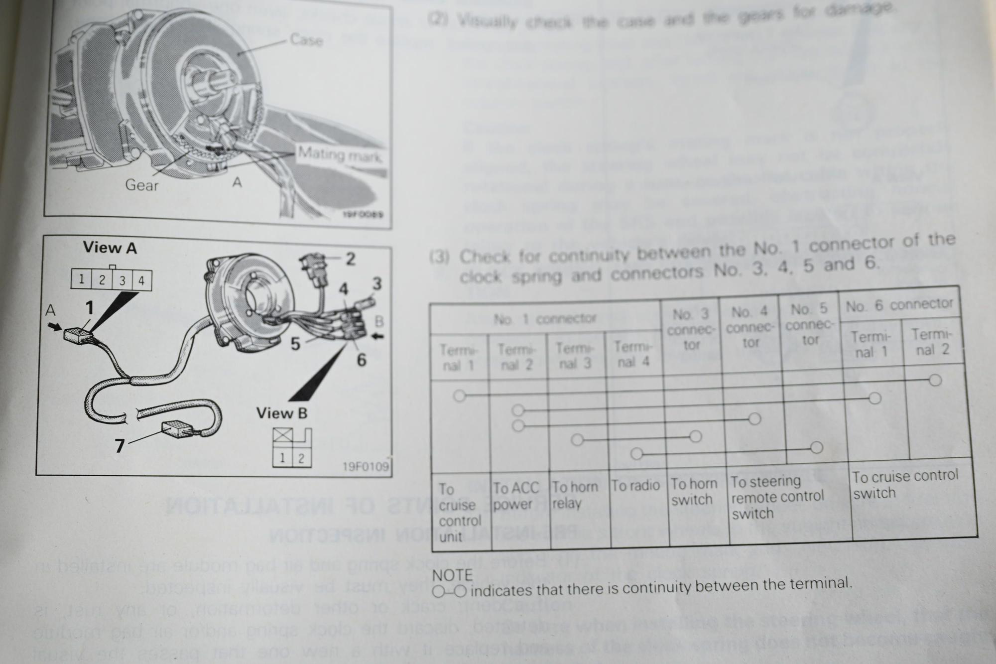

I have two issues concerning my '91 RT TT for your consideration.
The first one is: I've had an SRS light on for some time now, so I've decided to see if I can figure it out. Looking at the picture from the service manual, can anyone tell me where the number 1 connector is (View A)? I've pulled the side panel showing the red shielding going back to the ECU, but I can't find the 4-pin flat connector (View A). I've also dropped the bottom cover on the clock spring, and can't see it under there either.

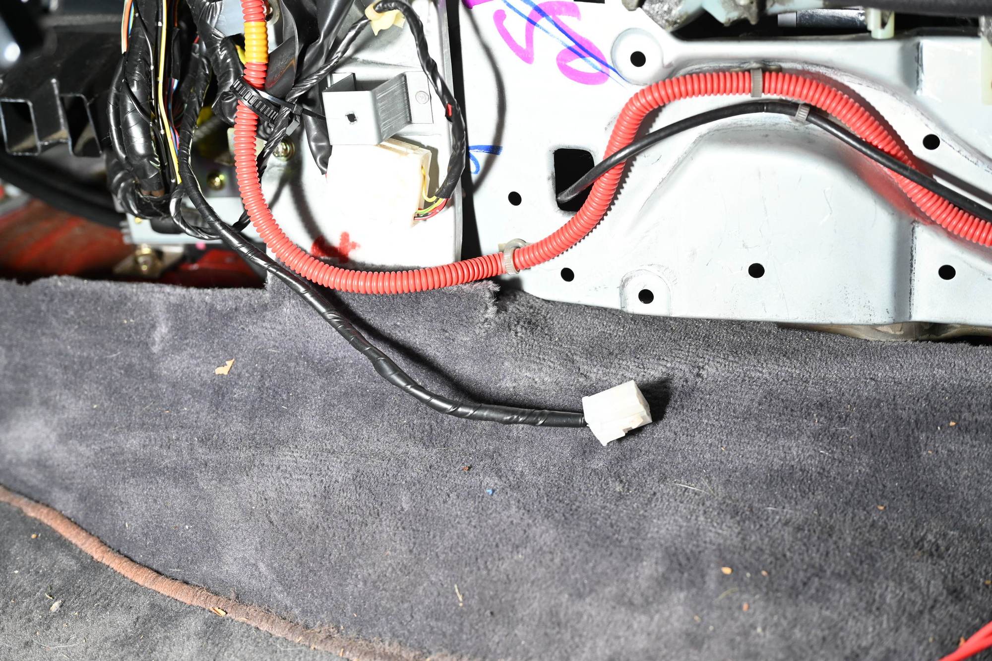

Secondly, does anyone know what the 4-pin white connector lying on the floor is for?
Any help will be greatly appreciated.
