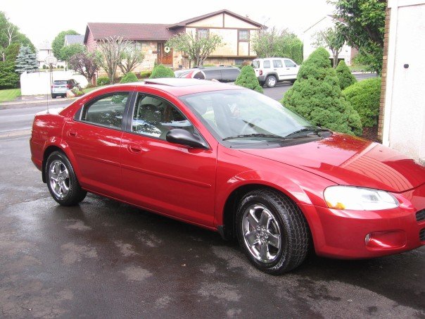

Kc8wx: I also put Altimax's on my stratus in the spring ...sure are a damn fine tire for the price I have about 22,000 miles on them and it looks like I should be able to get another 10,000-15,000 miles out of em ....if I keep the car that much longer. Good luck with your stratus ...i love mine to death but I just don't have the time or patience to deal with all these issues (i'm in college and my commute to school is about 20 miles each way so I need something more reliable) or else i would keep the car.
(P.S. The pic is before I put the tires on)
