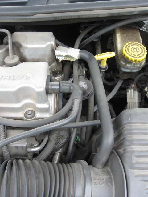

I have a hose on my 01 stratus that needs to be replaced. Autozone said they thought i could only get it from the dealer and it would be $40-50. I don't know much about cars, but this is just a regular looking hose. Can some someone tell me what it's called and if I really have to get it from the dealer?
Thanks!
Here's a pictures. It the hose that goes from the area where the air filter is into the engine it appears. I have duct tape on there for now till I can get the part.

i cant tell much from your picture...but it looks like an engine crankcase vent hose.

Had to replace mine because it was cracked and Autozone told me the same thing that I had to purchase from the dealer. The cost of the hose, here in the New Mexico, was about $16. Hopefully this helps you.
Yes it is.
Fuel injector line should work and it only costs a few dollars. It won't look as neat though.
