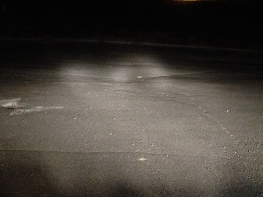

Hey there guys I currently own a 2002 dodge stratus coupe and I had a body shop put in new headlights for me because I couldnt figure out how to put them in and it came out like this Name:  photo.jpg

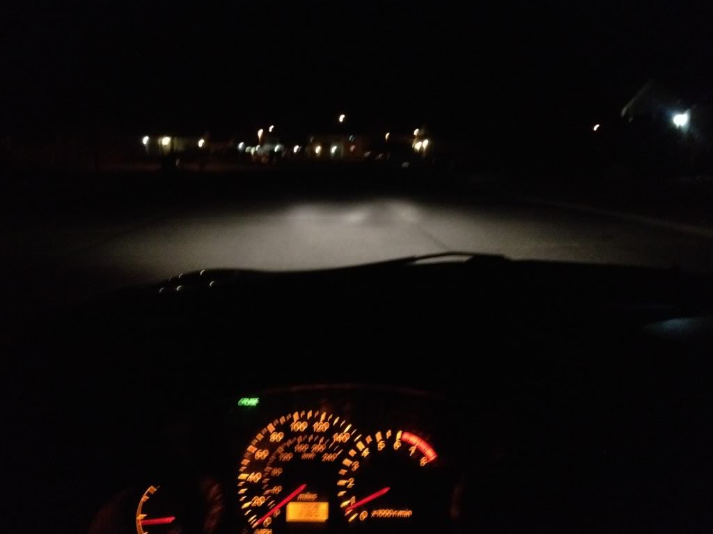

And it also looks like this from inside the car

As you could guess having the bright circles (located directly in the middle and reach out pretty far) within the bulbs light is very distracting and I was wondering how I fix it? It seems to be super bright in like a couple areas, brighter then all the others.

Im really surprised they didnt aim the headlights for you. Google the procedure to be 100% sure, but you will need to find a level surface, with a big flat wall. You have to be a certain distance away, and from there you can adjust your headlights to the right height. Open the hood and on the very back of the headlight you will see two adjusters. I believe they are allen heads, but are capped off with white caps from the factory. One will move the reflector up and down, the other side to side.
