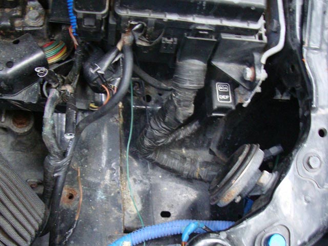

#2 - the car has some cut wires in the engine bay...going to the fuse box. Is there a wiring diagram of what each of these does? Could they be causing problems?

Here is the photo of the area with the cut wires.

2) Cut wires certainly do cause electrical problems. The thing is to figure out what they went to. If they are wires from the factory harness then you can look at a wiring diagram to figure out what they are for. Be sure to write down each color wire on a sheet of paper, then write down what it is for when you find it on the wiring diagram. Sometimes your local library has or can get the diagnostic manual(s) for your car. That can save a bunch of cash...

That picture of the cut wires isn't very good. You'll need to do some work on this yourself. Get a pen and paper and write down all the wire colors that are cut. Those wires that are in the 'blue loom' can be ignored at the moment. They aren't factory wiring and will only add confusion to an already difficult problem. See if you find two wires that have the same colors (indicating 'both halves' of a cut wire), if you do, tape them together and have someone do a proper repair (solder and shrink wrap). The more work you do now, the less money it will cost you. Write back with the list of wires you found cut.
