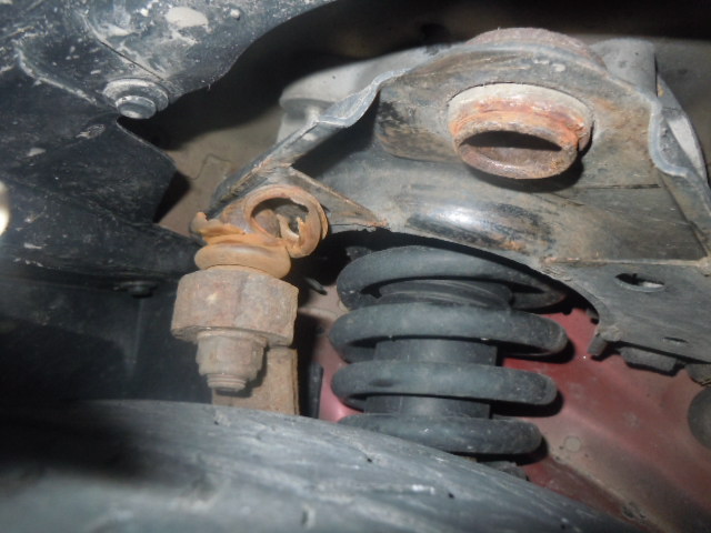

Question Busted front upper ball joint
My front upper ball joint busted out, control arm is still intact, do we HAVE to replace arm, or can we just replace the ball joint????Busted front upper ball joint-dscn1591.jpg
Old Apr 16, 2013 | 11:07 AM
BillS's Avatar
BillS
Joined: Mar 2011
Posts: 554
you can replace just the ball joint(think when i did mine joint was 16.00 and control arm was 50.00 at autozone i just did arms since i was doing struts also) ,most likely have to be pressed in, you can rent tool from autozone,not sure if it can be done on car your might have to take strut assembly out to get enough room
Old Apr 20, 2013 | 01:31 PM
smokesxt's Avatar
smokesxt
Posts: 1,111
Likes: 8
From: poynette WI
If I recall right the only way I could buy the upper was to get the whole assembly.
