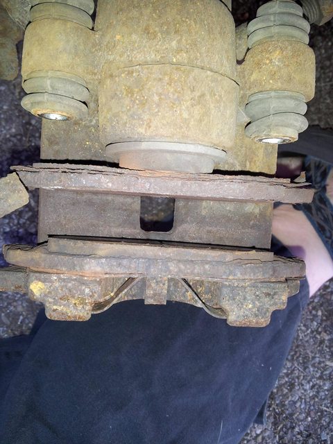

THESE are the brakes from the driver's side, that the seller SWORE were changed not 8 months ago. the right side was no better
