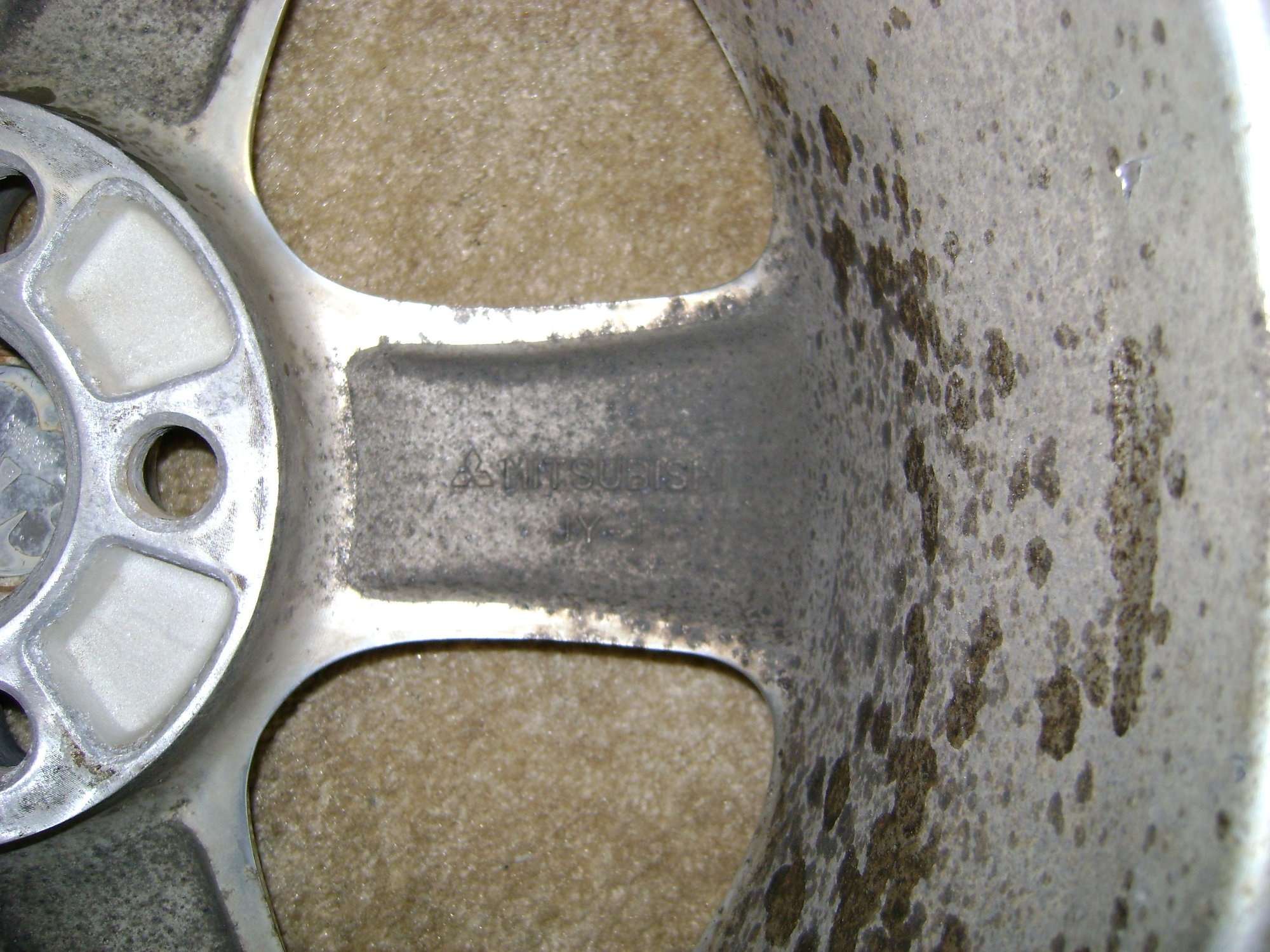

I was so excited to see these wheels listed on Craigslist. The title read "Fits 2004 Dodge Stratus". It would have made my Plain Jane 04 Stratus look cool. I traveled 2 hours to make the purchase, waited 2 hours to get the tires mounted only to find that they don't fit my car. I can not explain in words how upset I was. So with this said, I need to sell them to someone who can use them. They are in near perfect condition. Please help me identify which cars/trucks they would fit. Is there a wheel decoder website anywhere? THANK YOU SO MUCH.
The stamp inside reads: Mitsubishi 17x6.5JJ,46

The 17x6.5 is the wheel size itself, 17" diameter and 6.5" width.
To find the lug pattern, you need to measure the holes.
Notice in the diagram, on the 5 lug you measure from the center of one hole, to the back edge of the other.
Common Dodge wheels are 5 on 4.5" Meaning 5 lugnuts, and a distance of 4 1/2" between lug holes.

Some newer wheels are metric, (at least some makes, not sure about Dodge) so a caliper is best for measuring.
Once you know the lug pattern, then you can sell them.

Stratus Coupe. Probably some Mitsu cars.
The Sedan and Coupe are 2 completely different cars.

Like mentioned, those came off an 01/02 Stratus Coupe RT. 5x114.3 bolt pattern. +46mm offset.
