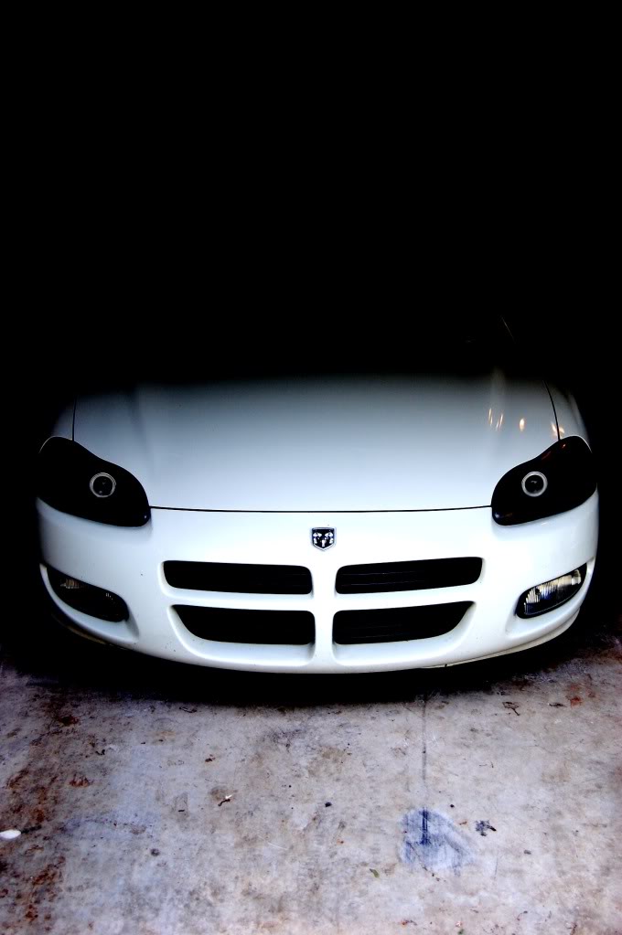

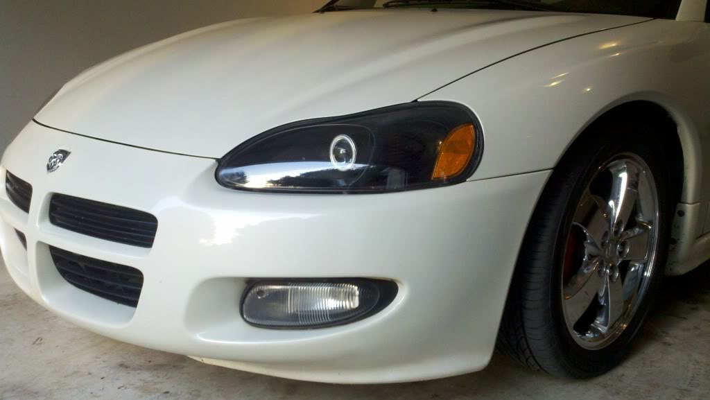

01-05 Stratus Coupes are the same mechanically as the 00-05 Mitsubishi Eclipse. Aftermarket body parts for the coupe are rare. Only a couple bodykits and hoods were made about 10 years ago to my knowledge.
01/02 Coupes are the same and 03-05 Coupes are the same. Only differences are the bumpers, trunk lids, hoods, headlights and interior. Fenders and other things are the same
For the headlights youll need to go custom. Bake them in the oven at 250* for about 10 min to soften the glue and you can separate the lenses from the housing.
Here are some projectors I did

So I have a 01 RT and the previous owner hit a deer and fixed the car himself. The headlights and bumper are the wrong trim. Gonna get a full bodykit to take care of the bumpers issue but need new headlights that curve ontop that line up with the hood. How much are projector retros made to order?
Is there any chance that you would be willing to make a pair for a price?
