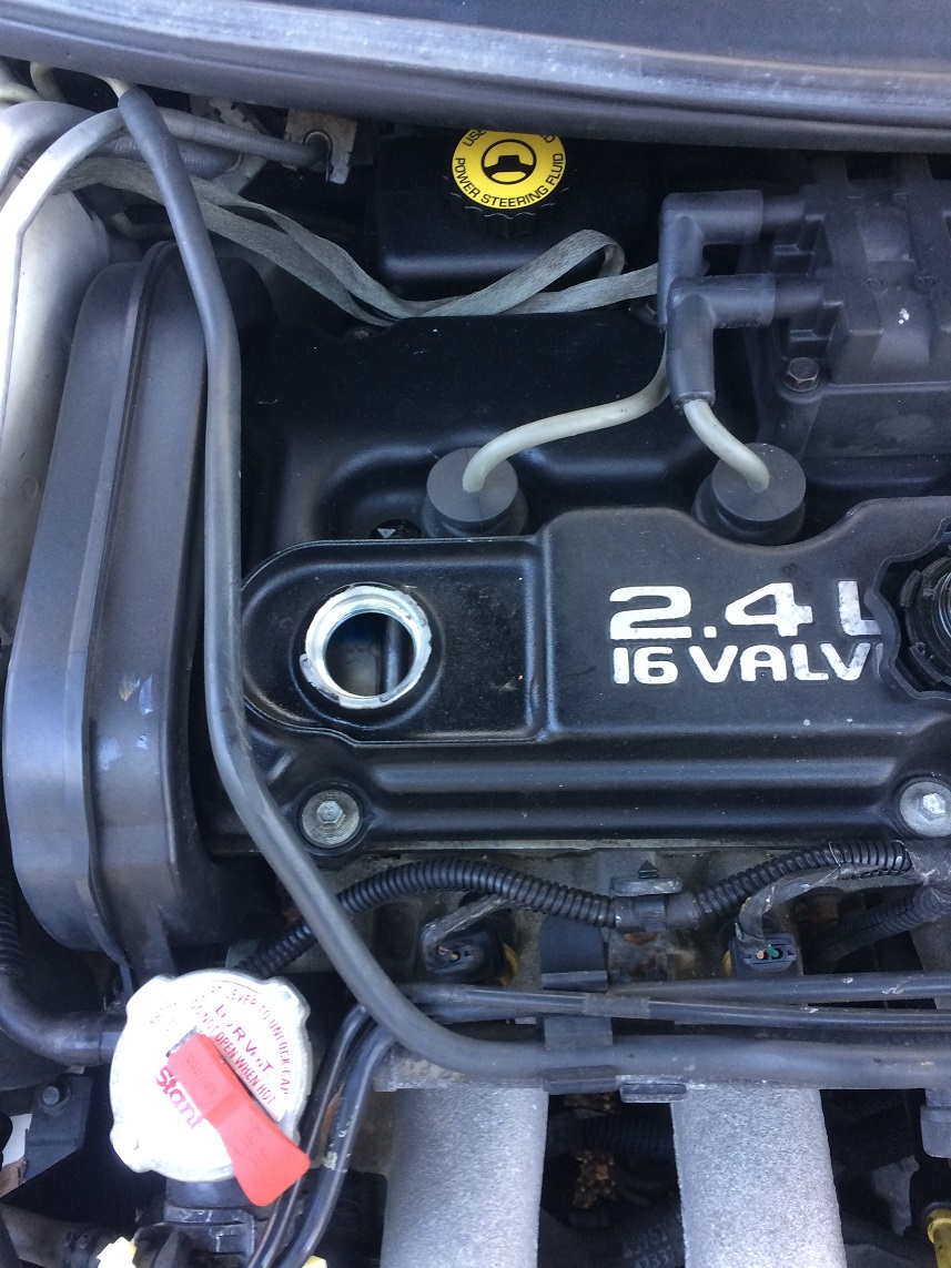

Sadly it's looking more and more as a head gasket issue.

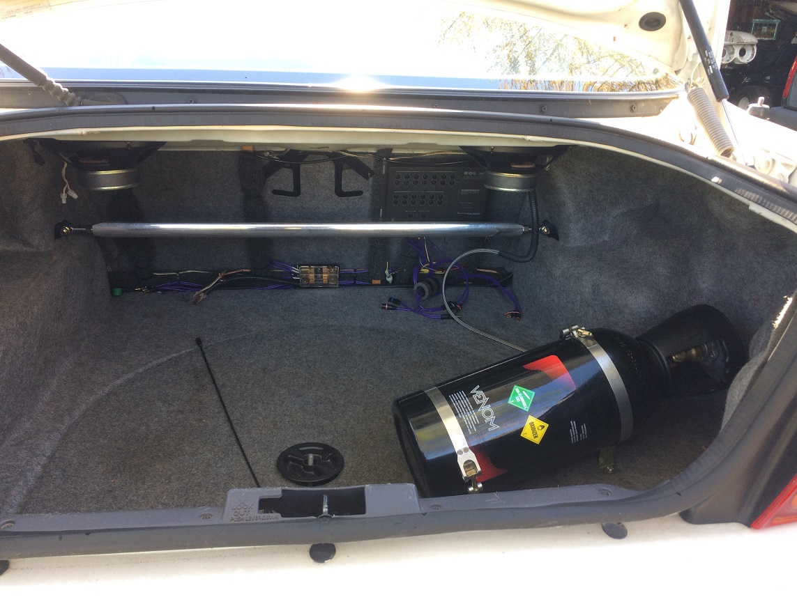

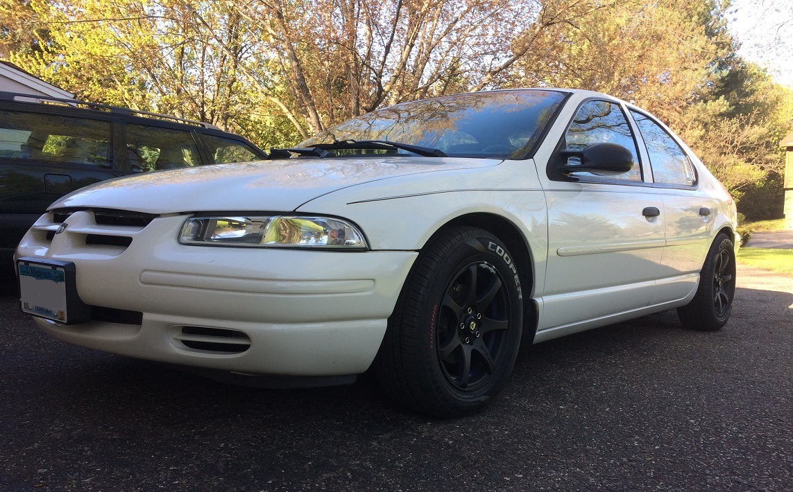

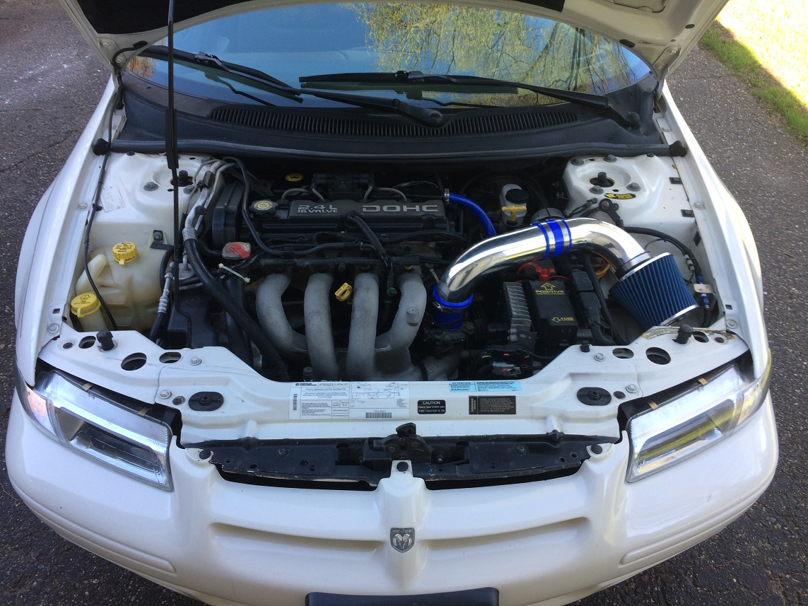

The car was in a barn on blocks with no wheels for over 10 years. Heavily modified with nitros injection, fuel mixture sensor, professional lowering kit, koni shocks, frame stabilizer, converted to all disk breaks and many more things (still evaluating it). Came with some parts too including engine parts like cam shaft, valve lifters, new intake manifold ... etc. Apparently it was used as an experimental car for high performance modifications but a divorce put a halt on the project 10-12 years ago so she ended up in a barn at a farm. I got wheels for it and was able to drive it home (45 minute drive) but shortly after started to act up.
It's a 2.4, 122K miles, automatic (did they make these manual?) well maintained, even looking inside the engine looks as it was brand new. Very clean car, including engine compartment.
No engine light but doesn't seem to have any lights on the dash. Gages all work but not a single light so I'll have to take that apart too. Maybe it was meant to be a racer or something eventually?
