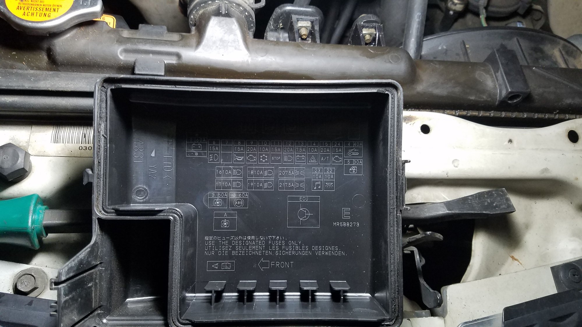

Ok, thanks for being patient, got a few pictures here.
Engine bay fuse box
Engine bay fuse box cover
Driver side fuse box, passenger compartment
Driver side fuse box cover, passenger compartment
I direct wired the pump today and tried to start the car. I definitely have fuel going into cylinders, I know I have spark at 1 and 3, so I would assume that I have spark at 2 and 4, since there are only two coil packs. I heard there may be an ASD relay, but I have not found enough information on it for this car.
