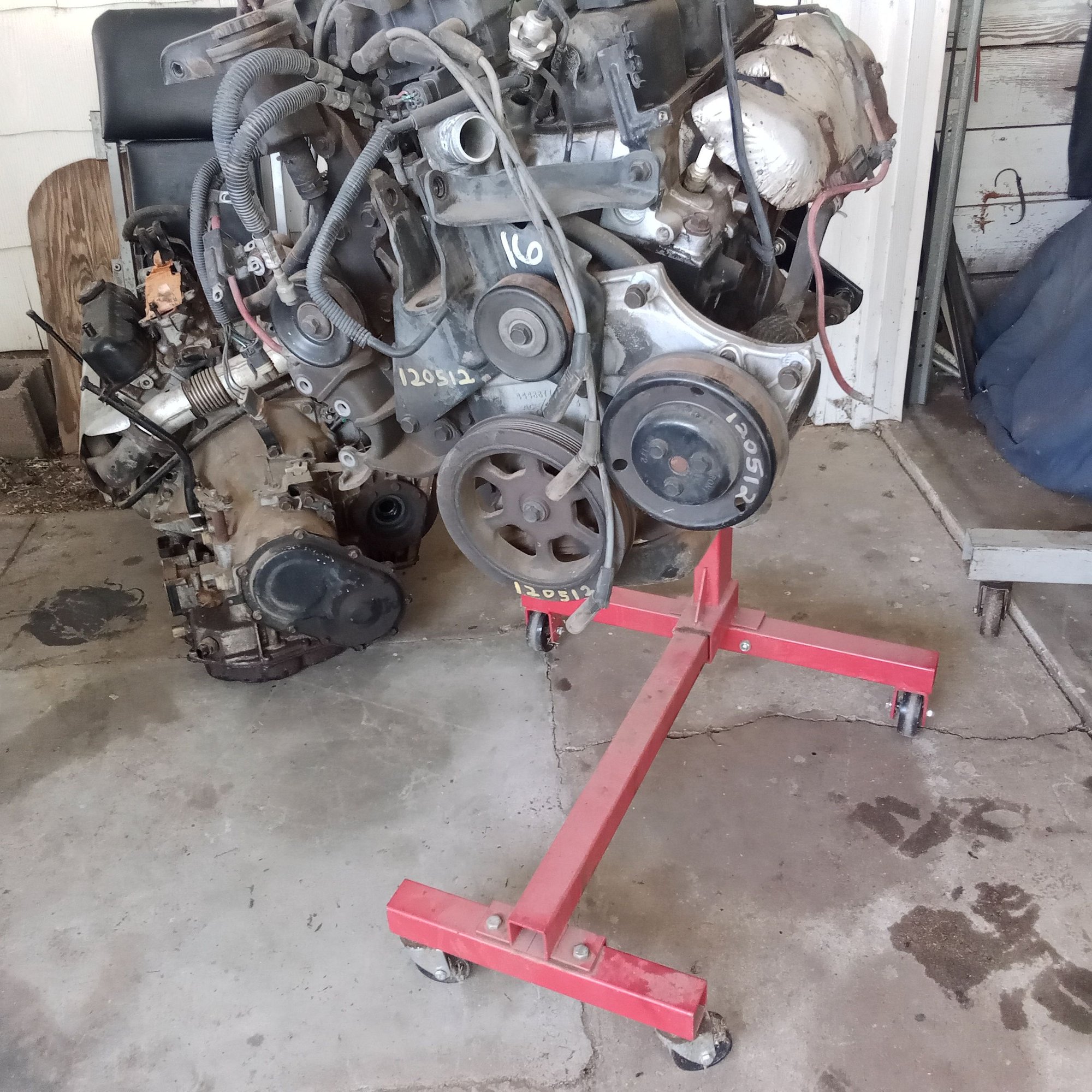

I do not know about your engine, mine is different A V6 with a chain. The one item that would concern me is the lower crank pulley. Sounds like a simple item.
On my engine the pulley is somehow pressed on .... You need a Biiig puller to get it off. For that reason alone, they will drop the trans-axle out of the vehicle and do the work with the body on the lift in the air and the engine, transmission on the ground where they can get to everything. ..... It is a big job.
I just took mine apart on a blown up engine to see what went wrong, I was not putting it back together. The pulley does not have a slot for a key way is simply extremely tight so it does not spin.
So to re-assemble, you can not just take a 3 pound sledge and drive it back on .... you would damage the crank, bearings, seals etc.... There is a trick to it and some day I will learn it .... I'm thinking to put the pulley in a freezer overnight so it expands then quickly slide it on ????
Only point to bring this up, there will be some things here that if you are not prepared for .... this project could go sideways really fast.
