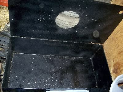

Was thinking of putting a 22 gal fuel cell in bed but keep the stock tank? Is there a way to make it so that the fuel run to stock tank?this is what I have, Also hade a stele box made for it
