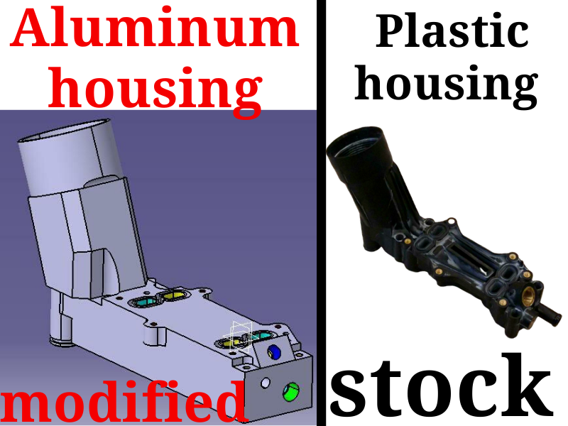

This problem is solved by replacement of oil strainer housing assembled. Unfortunately, reliability of knot is insufficient and this decision – temporary and doesn’t guarantee disposal of oil leak forever. Also there are very frequent breakages of this housing when tightening or untwisting plug of the oil filter housing. The case can leak at any moment and at any run. And you won’t know when it’s necessary to change this knot again and on how many far you will be from the service station. The leak can be so strong that the engine will lose very quickly oil and it will be impossible to continue the movement. Your trip can suddenly stop because of this breakage.
Replacement of knot beforehand also won’t give any guarantees.
It’s sure that the producer knows the plant about this problem, but in 10 years of release of Pentastar hasn’t proposed the solution.
The design of housing of the filter, which was changed by the producer in 2014, hasn’t helped with reliability in any way. I will remind that my case has spontaneously leaked at 59000 miles. The decision is possible only one here - replacement of material of production of this detail. Only it will give the necessary strength, ruggedness, thermal stability and durability to knot in general. Only thus it is possible to provide the necessary reliability and forever to forget about this problem.
As I very much like my car, and will continue to operate it further, I want to make aluminum detail instead of plastic one.
The housing will be manufactured of massive aluminum plate by method of milling and will be compatible to other details making knot.
Works have already been conducted and somewhere by the beginning of spring I will be able to carry out tests on the car. If tests are successful, this problem will be solved completely and for a long time.
It’s interesting to get know your opinion on my option of increase in reliability Pentastar.

Welcome to the club. The 2014 3.6L pentastar used on multiple Chrysler-Fiat products is apparently notorious for this problem.
They re-designed the plastic oil filter housing/oil cooler for 2014 with an "improved" design, that is known to crack easily, requiring the top of the engine to come apart for replacement. The part was updated for 2015 models, and the dealer will be happy to change it for you to the tune of a cool $1000 if you are past the 5 year/50K mark on the warranty.
