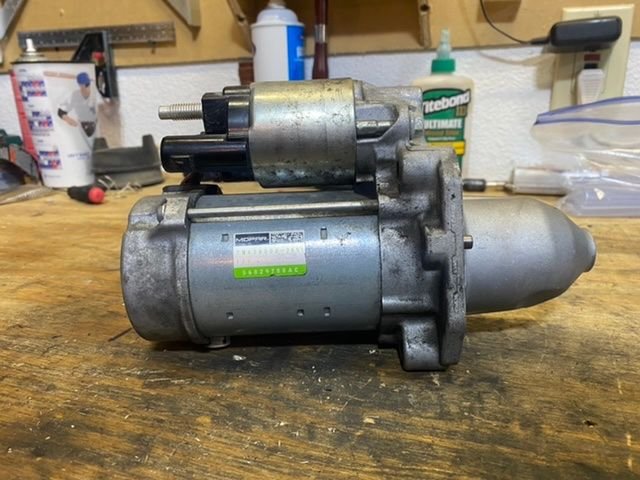

I didn’t know at the time it was ordered, but it was an AC Delco 336-2185. Initially it looked correct but once I got it side by side with the original, it was clearly not a match. The nose cone is much shorter and the bolt holes don’t line up.

I just wanted to get the word out that if you’re searching for a replacement starter for these 3.6 engines, don’t trust that specific AC Delco as a replacement.

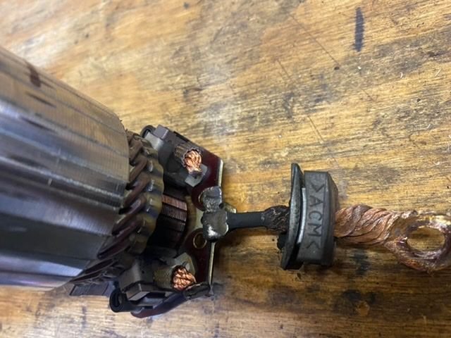

Also, just for kicks, I decided to see what happened with the starter for myself before having it repaired - the solenoid coil had shorted to ground and the power wire between the solenoid and motor had broken free of the brushes.
