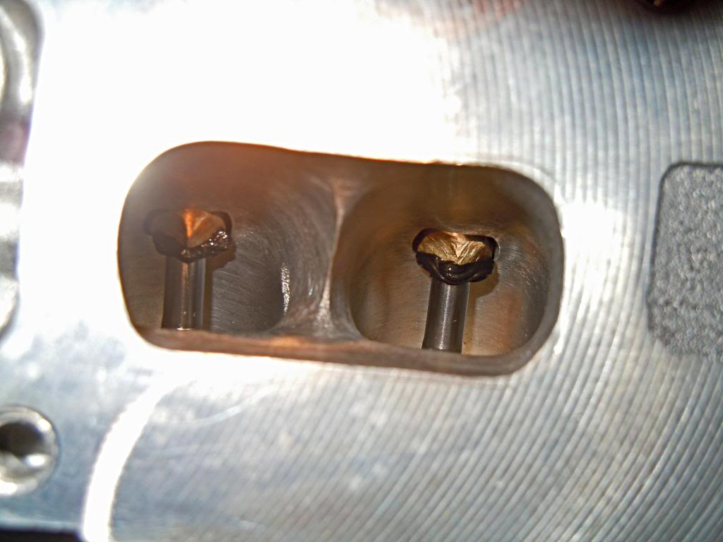

Default Map stage 5 srt-4 head
Got my MA Performance Stage 5 head (there are only 5 stages) in today. Here are the details below along with pictures.
Brand New OEM Head
MAP Custom Performance valve job
Fresh deck resurface
Stage 5 Porting
Upgraded Seats
Rev Valves +3mm Exhaust Valves
Rev Valves +1.25mm Intake Valves
Rev Valves Dual Valve Spring
Rev Valves Ti Retainers for Dual Spring
Rev Valves Spring locator for dual springs
Rev Valves Valve Seals
Mopar Single Groove Valve Locks

Thanks. According to the company it will flow 313 CFM on the intake side and 248 CFM on the exhaust side.

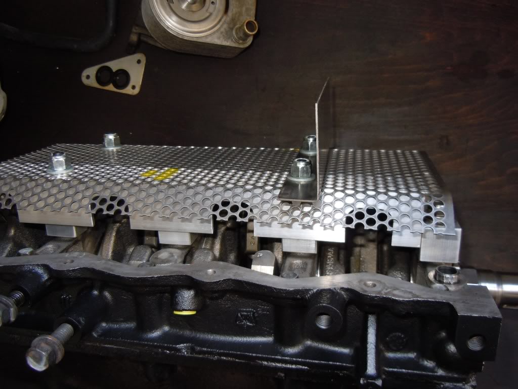

Short block is done. Block is decked and 90 degrees to the pistons. Crank shaft is polished. All internals are balanced and blue printed. Block has also been repainted black.
